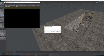

Lightwave crash on win 10 when opening ipr window. See attachment. No fancy scene, just the sponza model. I'm on windows 10 64 bit and have an RTX 2070 card. Tried different version of the plugin, but they crash. See attachment.

Which build of win10 is it and what nvidia drivers/octane version you are using.

Nvidia 25.12.1972 driver
and
1.15204.20580
windows 10 10.0.17763 Build 17763

Do you have unfamiliar letters in "sponza"-models material names? (Etc. Ä, Ö, Å,...)

That is some weird driver naming, Nvidia drivers currently are at 4xx.xx number so not sure did you looked correct but anyway you should install Nvidia Studio drivers 435.xx or newer.
As for windows that should be build 1809 from year 2018 so you might want to update your windows also but try drivers first.
Granted that is IF you are using Octane 4.05 or newer. If you are trying v3 or older then you'd have problems with new drivers.
