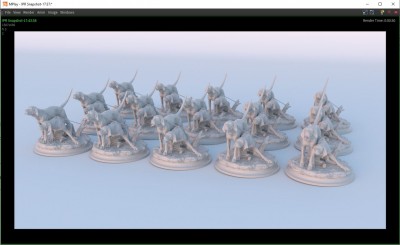

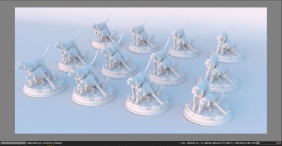

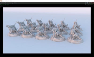

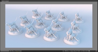

Just tested similar scenes in Octane standalone and Houdini with Octane 2020. RTX works just fine in standalone but it has no effect on the scene in Houdini.
I'm sending a dropbox link to the models and the octane standalone scene and houdini scene so you can test it. You'll need to reload the models.
I am on the latest nvidia drivers. Testing with a single 2080ti
https://www.dropbox.com/sh/xc4zrojf1x92 ... Oh2Ta?dl=0

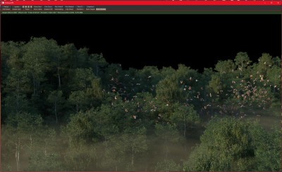

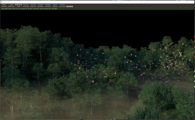

I ran a test with motion blur off (quite an unfortunate feature to be broken), and yes indeed it works. Still some features missing but I do believe these were fixed in the new XB2 stand alone build? so I can only guess we will see them in the next houdini build too.juanjgon wrote:Sorry, I'm still investigating this issue. It seems somehow related to the motion blur. If you disable the MB in the ROP node the RTX feature seems to work fine ... I'm trying to figure out if this is some kind of Octane limitation or a bug.
Thanks,
-Juanjo
I am getting a 2.33x speed increase with RTX ON.
Added auto bump map support for RTX primitives.
Added support for UV sets 2 and 3 for RTX primitives.
Added support for vertex attributes for RTX primitives.
Particularly the vertex attribute is apparent in my test images as you can see on the trees in the RTX on version, the colour variation driven by attrib isn't working.
