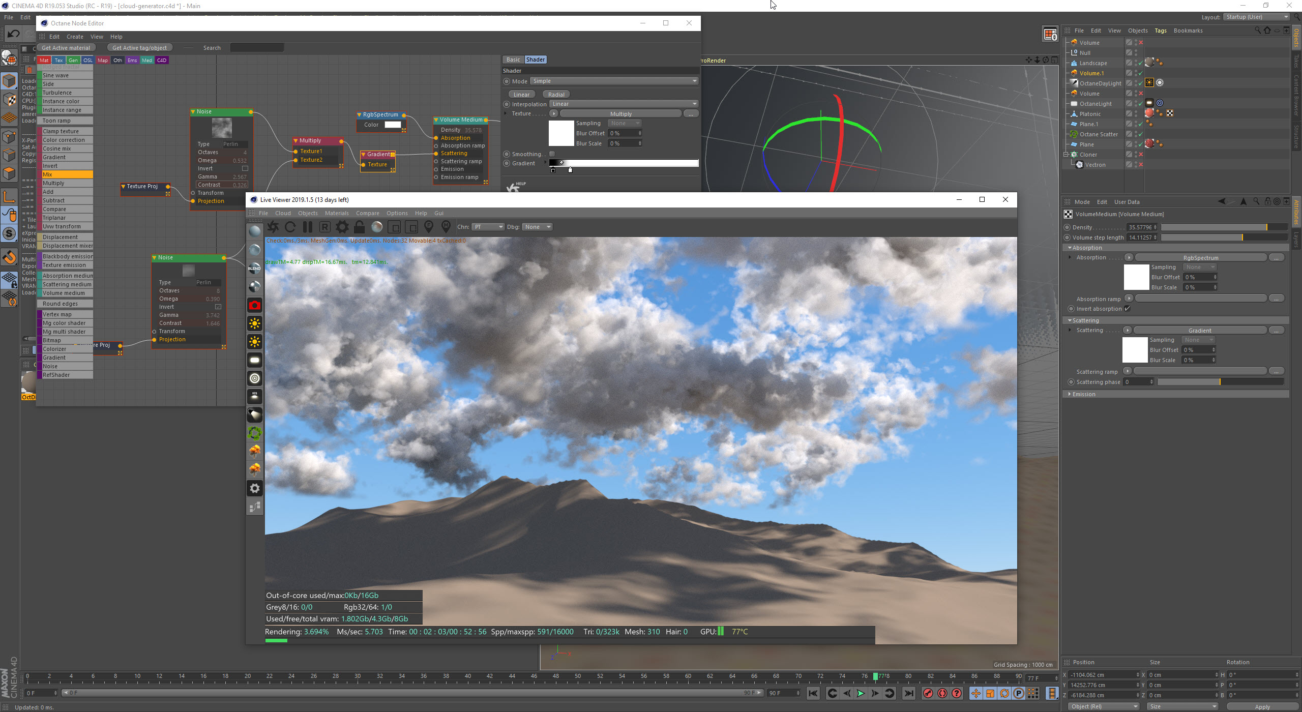

It's old way to immitiate the detailed fogs. Do not increase voxel counts and try what I say for another method.
Take a look to my sample scene how I can generate very detailed clouds without much voxels
