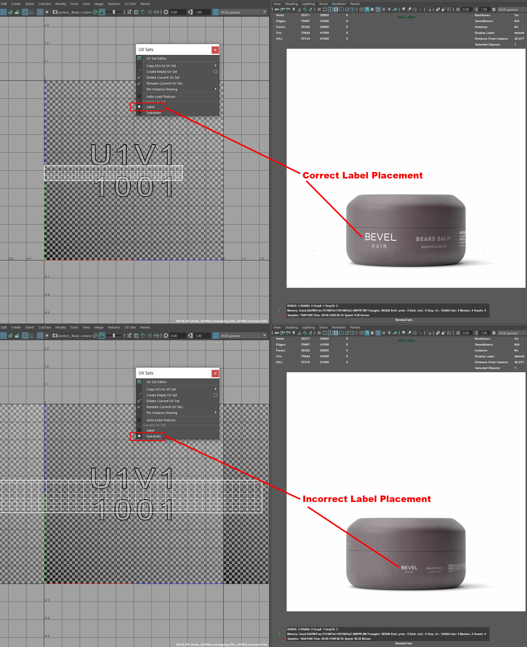

On an object with multiple UV sets, the set to which a texture is projected to is affected depending on which UV set is selected in the "UV Sets" drop down menu of the UV window.
Observed Behavior: A bottle has two UV sets. Depending on which UV set I have showing in the UV editor window, affects which texture is assigned to which UV set.
Expected Behavior: UV Set assignment should only be dictated by the UV Projection node of a texture, and should not be affected by which UV set is currently selected in the UV Editor Window.

In the meantime, here's a screenshot of what's happening:
I have a mix material which consists of the screenprinted label and also a blank substrate. Textures in the label are assigned to UV Channel 1. Textures in the substrate are assigned to UV channel 2.
You can see that by changing which UV set is active in the UV Editor, it's dictating which UV channel textures are assigned to, overriding the Octane "UV Project" node.
Shouldn't changing UV sets in the UV editor have no affect on the render? Changing that should only visibly changewhich UV's are currently shown in the editor and not actually reassign UV's?

If all your textures/references are inside the workspace - just make an archive of the whole workspace. But I think I already understand what you mean...
This happens because both Maya itself and Octane have their own means to control the current UV-set (where Maya can just have one current UV-set for the whole mesh, and Octane can be more flexible). So if you are trying to use both of them interchangeably - you can see them clash.
I've implemented the functionality of being able to use them both in Maya - so you can use the native Maya's approach in the simple cases where all the textures used by the same mesh use the same UV-set. In this case you can just always leave the default "1" value for "UV set" attribute in the related UV-projection nodes, and just be switching the current UV-set by standard Maya means, without even touching the Octane's UV-projection nodes... What happens in this case under the hood - the UV-sets of the mesh are getting rearranged during the translation, making the Maya's "current" UV-set to always be the first set (thus it will automatically be recognized by Octane, 'cause the projection nodes in such cases all have the "1" as the UV-set). But if some of your projection nodes have e.g. UV-set "2" in them - they will start seeing a different UV-set of the mesh as soon as the UV-sets sequence of the mesh gets rearranged due to change of Maya's native "current UV-set of the mesh".
So in more complex cases like this, you can't use Maya's simpler "one current UV-set for the mesh" approach. In such cases you need to always have Maya's "current UV-set for the mesh" set to the very first UV-set (to eliminate re-arranging), and never change it. In this case you need to be changing the UV-sets in Octane's UV-projection nodes to achieve the desired render result...

Is there any way to make a checkbox override to force octane's UVset assignments to take priority? In practice, all that switching the current UV, via the UV editor should do, is change which UV's you are looking at and have zero affect on switching UVset assignments.
Imagine setting up 20 renders to batch overnight and they all have to be trashed because you didn't double check that the correct UV set in the UV editor was selected--something that shouldn't, traditionally, have to be considered. I've already lost a few couple hour renders, accidentally, because of that.
