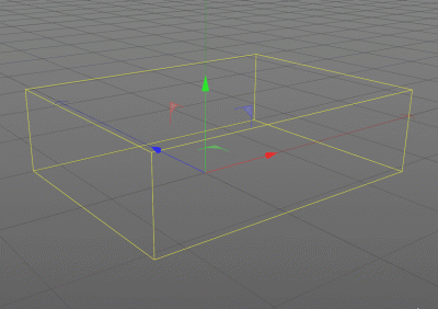

Does anyone have issues with rendering VDB in latest Cinema 4d plugin (2019.1.4 R2). It renders only 1 sample continuously. On 2018 plugin builds it is ok. Final render is fine on the other hand. The issue happens only when rendering in interactive viewport.

Here are my specs and example file:
A. Windows 10, 1903
B. 2xRTX 2080 (rendering), GTX 970 (display)
C. 64 GB RAM
D. Nvidia game ready driver 440.97
E. OctaneRender Standalone 2018.1.3 / 2019.1.4
F. OctaneRender plugin 2018.1.3 / 2019.1.4-R2
G. Cinema R21.115
A. Windows 10, 1903
C. 64 GB RAM
G. Cinema R21.115
