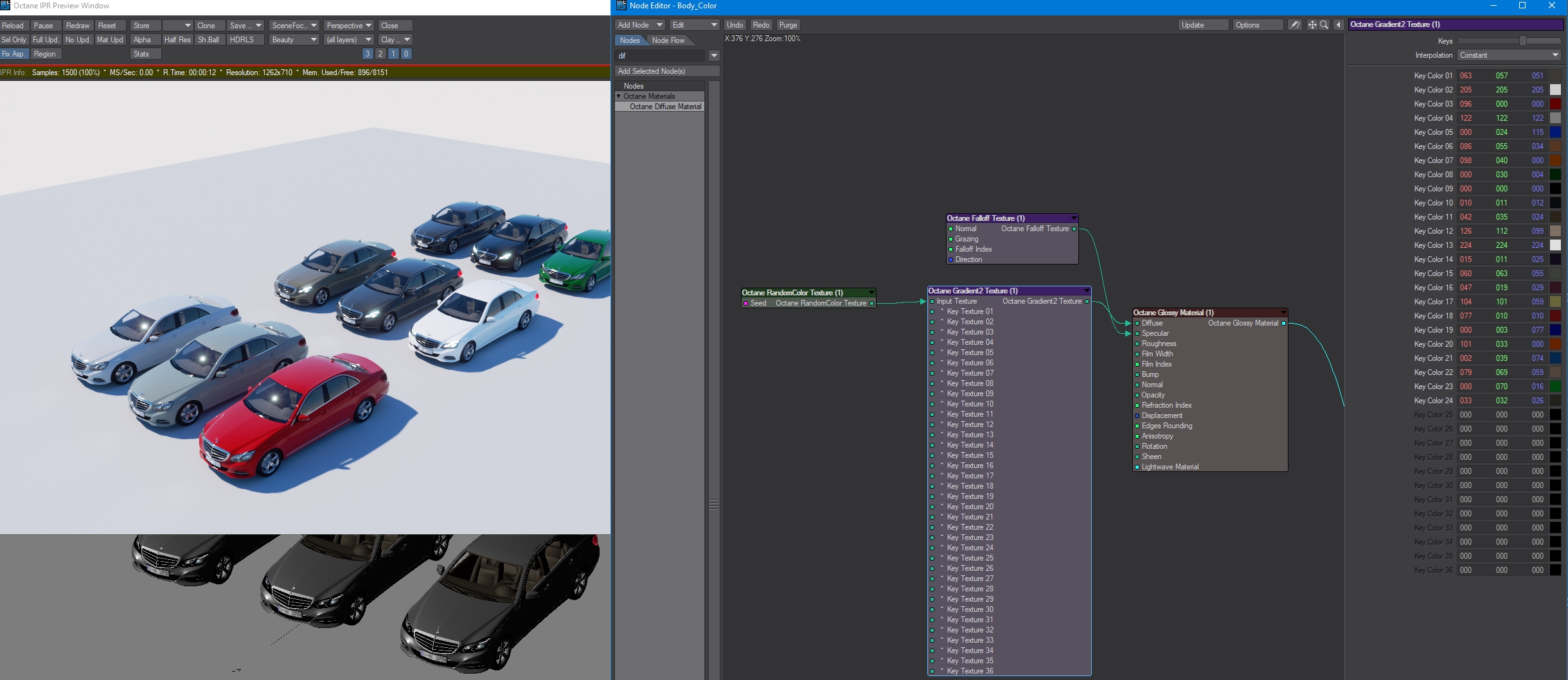

Just unplug the instance ID seed node and it'll work.
Here is my setup, works no problem on all instanced cars and it's NOT changing colors after reload.
Lewis

Lewis wrote:Hi Rene.
NOPE! this is not th reason.

Have you tried what my screen shows?
My cars have 7-9 layers (wheels and lights separated for anims).
Lewis
