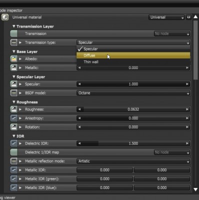

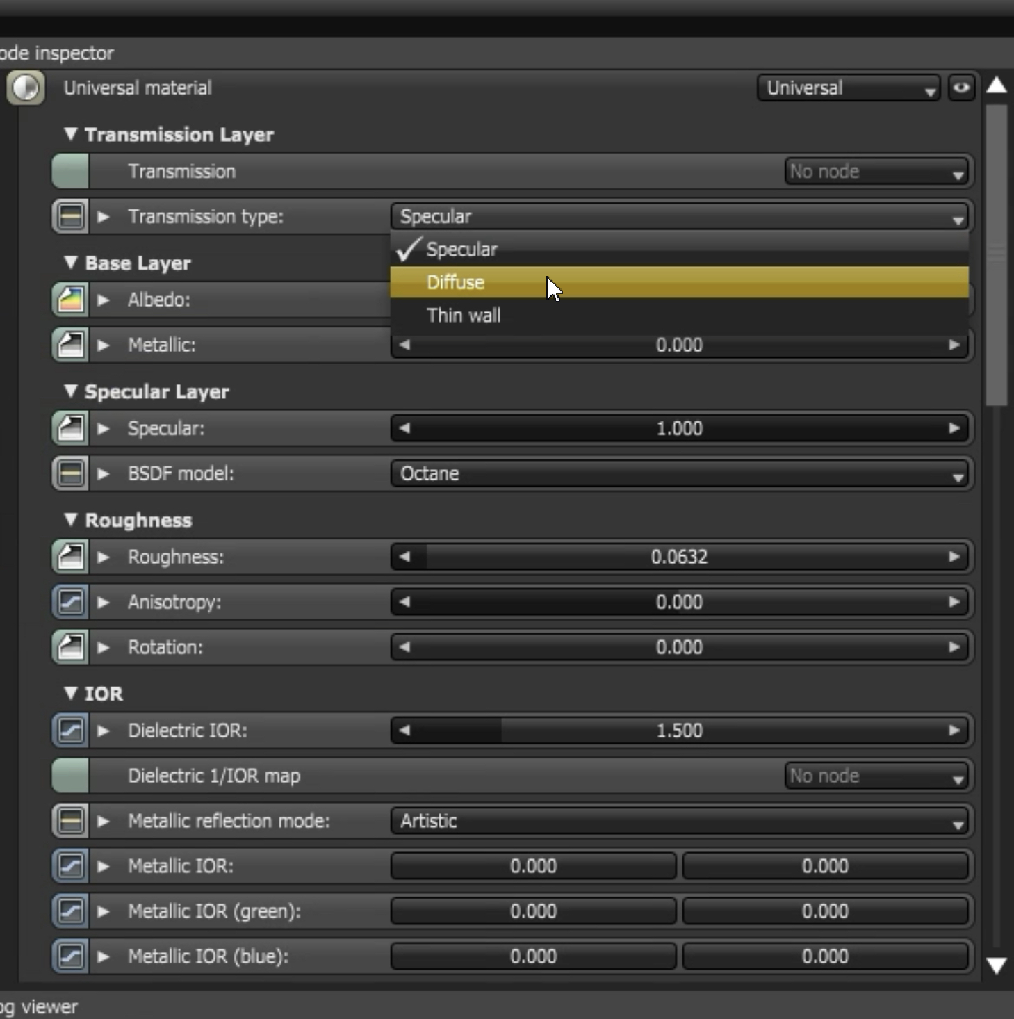

Posts: 10575
Which version are you using?
In latest 2019.1, and 2020, there is a Transmission Type popup, that can be set to Diffuse:
ciao Beppe
DanCaldwell3D
Posts: 13
Joined: Mon Dec 02, 2019 2:06 am
Thank you so much Beppe, exactly what I was looking for!

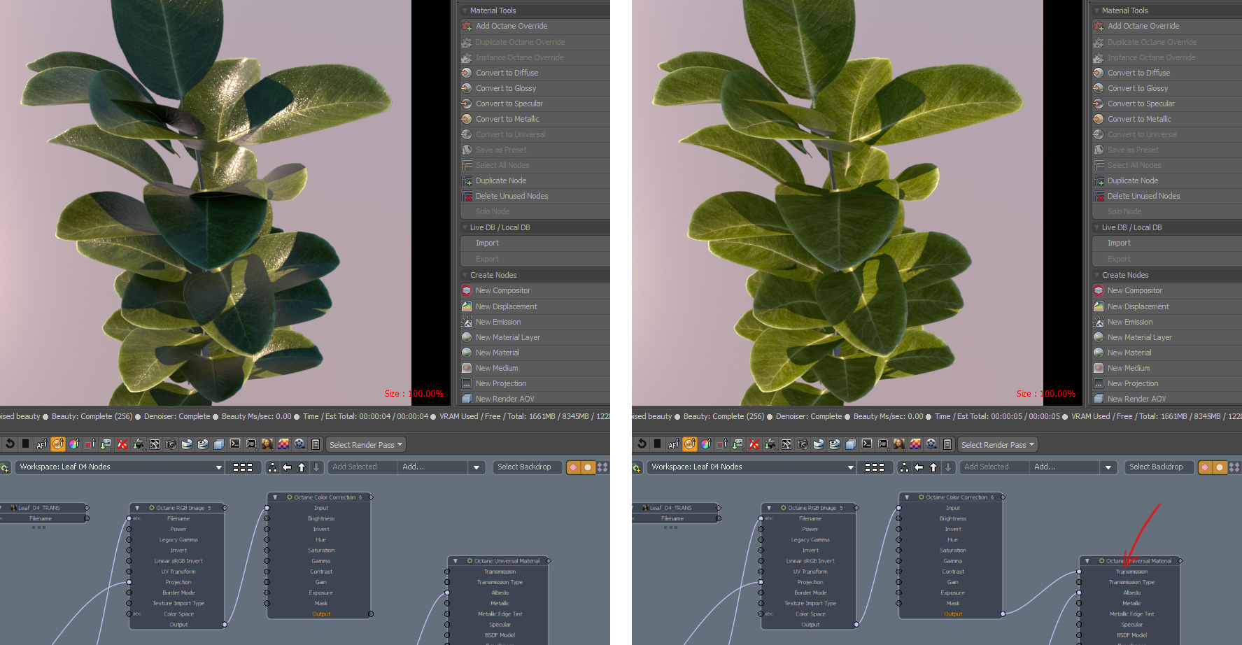

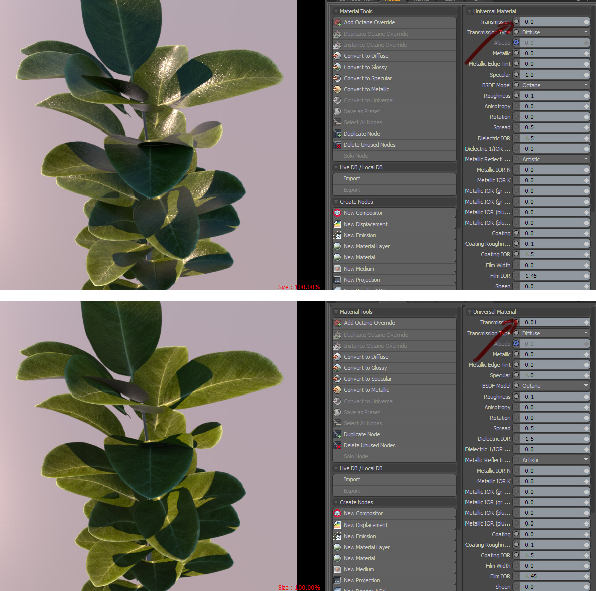

i've tried several ways to do this but they all have the same result - as soon as i make the leaf translucent any specular is lost
i've tried the layered material (Diffuse main + Specular layer, and Glossy main plus Diffuse layer), and the examples below use the Universal material
i've also tried adding a Coating and/or Sheen instead of Specular but very little difference
1st example is with a texture used for translucency
in the 2nd example - with just a value instead of texture - even with only 0.01 translucency the specular disappears
what am i missing?

Dingbat, can you try disabling kernel > nested dielectrics?
Wallace replied to a related issue here: viewtopic.php?f=23&t=78819&p=407037#p407037
Dingbat
Posts: 180
Joined: Tue Jul 21, 2020 7:49 am
no change
i've attached the scene with only a diffuse colour and 0.01 transmission
if you change transmission to 0 the specular will appear as expected
Nested Dielectrics is unchecked

What about this ? Should works fine now. You didn't have any Dielectric/IOR map. Also you can add a little metallic effect.

It looks like Transmission overrides Specular Roughness. When Transmission is ON even a little it switch to its own Roughness parameter that is much lower than Specular Roughness.
