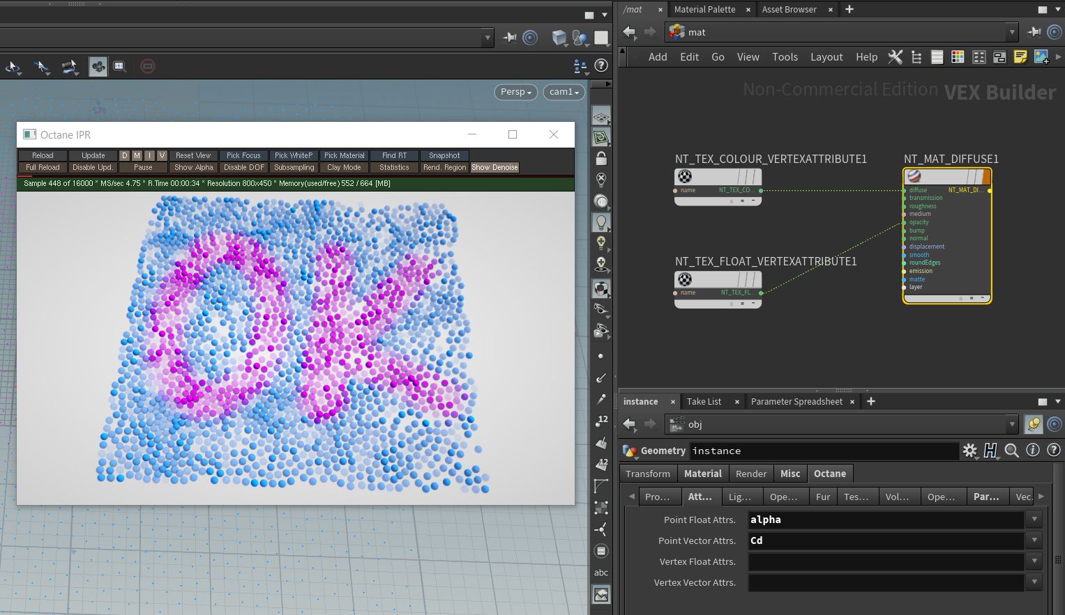

how i can use "Particle Point Attributes." ? there is no point Color attribute node in the mat context ? only vertex attribute node ?
any documentation or example is appreciated it .

realimageae wrote:Thanks ,
This feature works using the same nodes added for the vertex mesh attributes. You only need to declare the attributes to be extracted by the plugin in the Octane OBJ spare parameters attributes tab, and retrieve these attributes in the shaders using the color and float vertex attributes VOP nodes.

realimageae
Posts: 9
Joined: Sun Feb 10, 2019 11:26 am
Thanks,
-Juanjo
It's Works , thanks .
