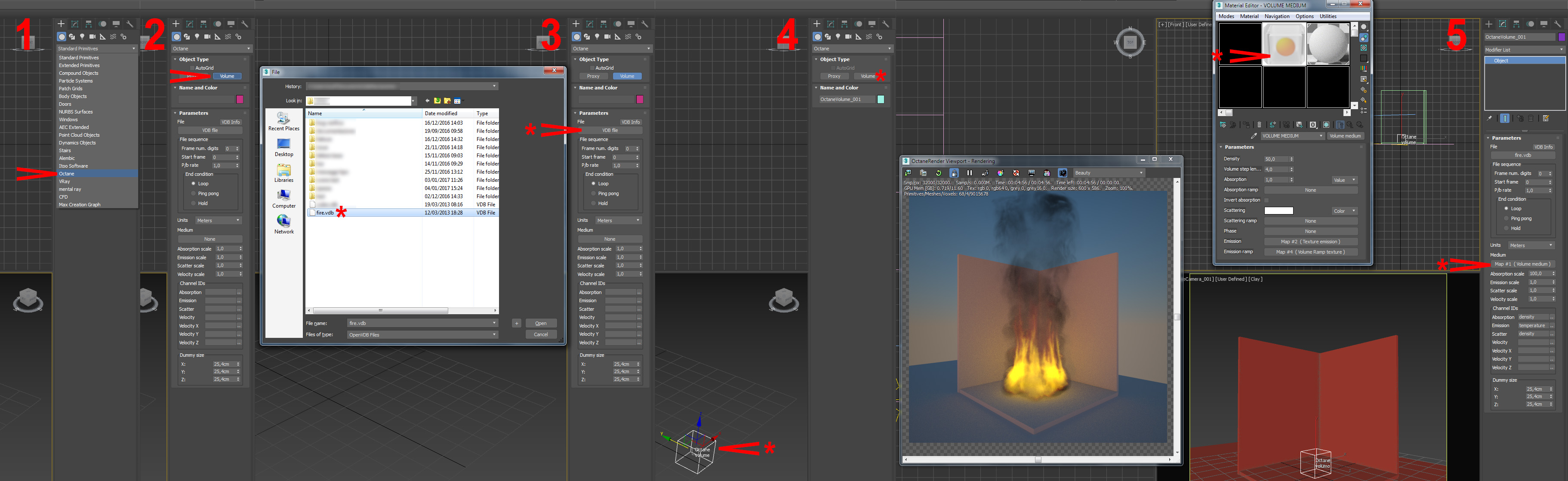

you can create your cloud .vdb using Sculptron 1.0
viewtopic.php?f=27&t=73278
