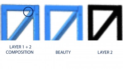

Whenever I render seperate layers you get a cutout from layer 1 in the second (back) layer.
What this gets me is a black AA line around my front layer. This isn't usable and the only way to fix this in post is to erode (nuke) / shink the background layer to fill up the black AA, but with that method I loose details in other transparant parts.
So my question is: Why does the background layer have a cutout from the first and how am I able to composit this correctly? (Ive done all the unpremultiplied / premultiplied passes before merging)
Thanks a lot

Have you tried changing the layers mode to "Hide inactive Layers"?
ruuterdetuuter
Posts: 86
Joined: Tue May 02, 2017 8:41 am
Wow, thanks! Didn't even notice that option.
You saved my day :)
