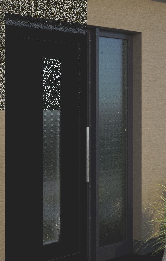

I have this strange problem, the door leaf is much darker than the frame, although both are the same material.
The interesting thing is that if I move the door forward and backward, the material comes back normal. but with other objects of the scene with this material, this does not happen.

Don't you have 2 objects on each other ? Try rebuild scene ? An "unseen by camera" at the same place ?

as HHbomb said, they seem some overlapped polygons.

I found the "problem", it was the BRDF Model, it was in Ward.
What is strange, because the door frame is with the same material as the door leaf, but it works correctly,
