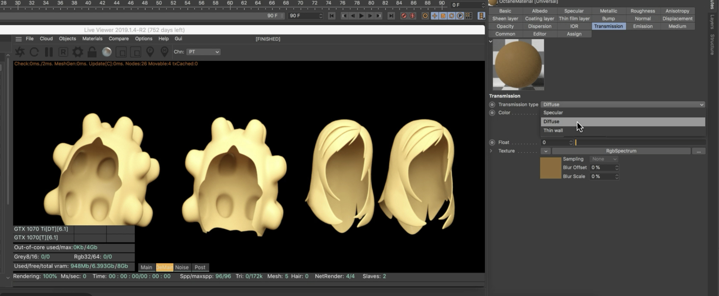

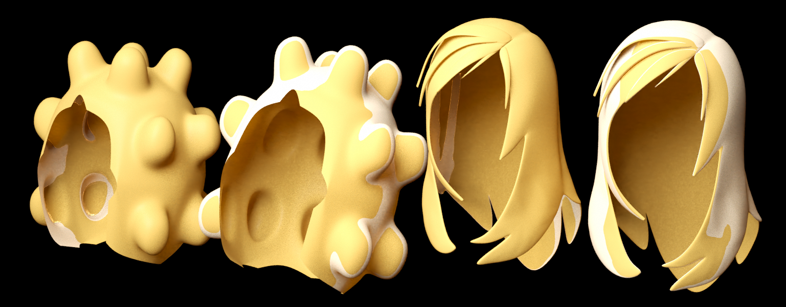

I don't have a good answer for you, but I played around with your sample a bit and have learned a little. From what I could see, the problem is specifically with the Universal Material in conjunction with Transmission when applied to concave, reverse normal polygons. At least that's the only way I could reproduce the effect.
Here's a simple demo scene, and render. Something funny is definitely going on, as you can see in the funky two-tone results. The odd noise is happening at the boundary of the tonal change.
Maybe this will be useful to Beppe & Co.
Universal Material Transmission Concave Normals Weirdness

Posts: 10598
Hi Frank,
big thanks for isolating the issue, the Universal material is not correctly setup in this case, you need to change the Transmission type from Specular to Diffuse in this case:
ciao Beppe
