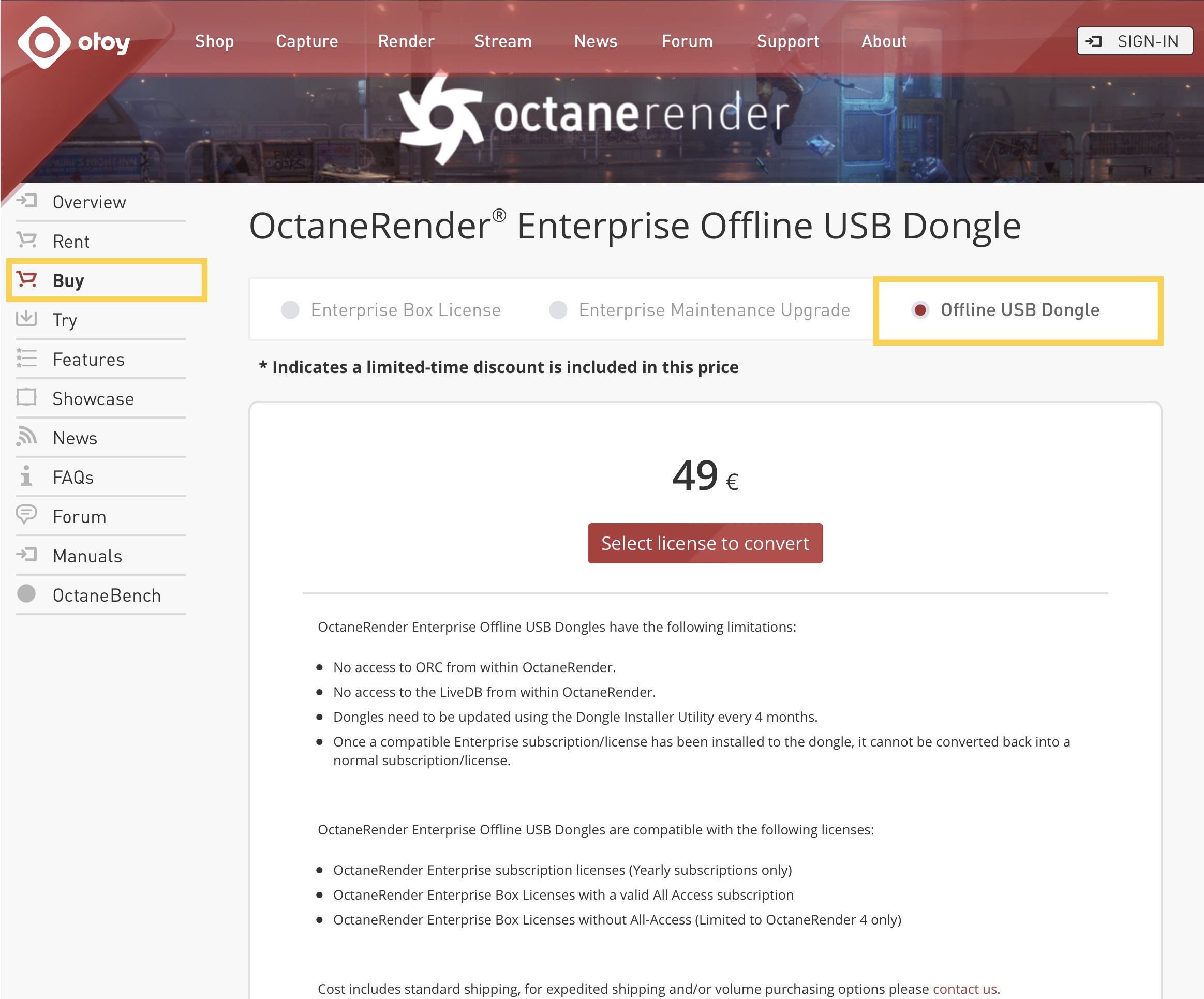

Note that from Octane 4.0 you need to purchase the new Offline USB Dongle option from the shop page, choosing the option in the top menu:
https://home.otoy.com/render/octane-render/purchase/ ciao Beppe
