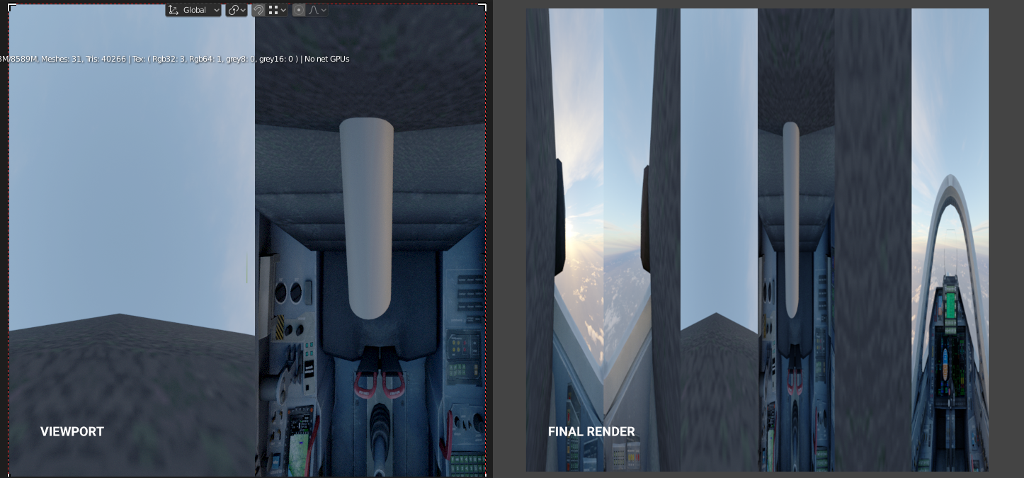

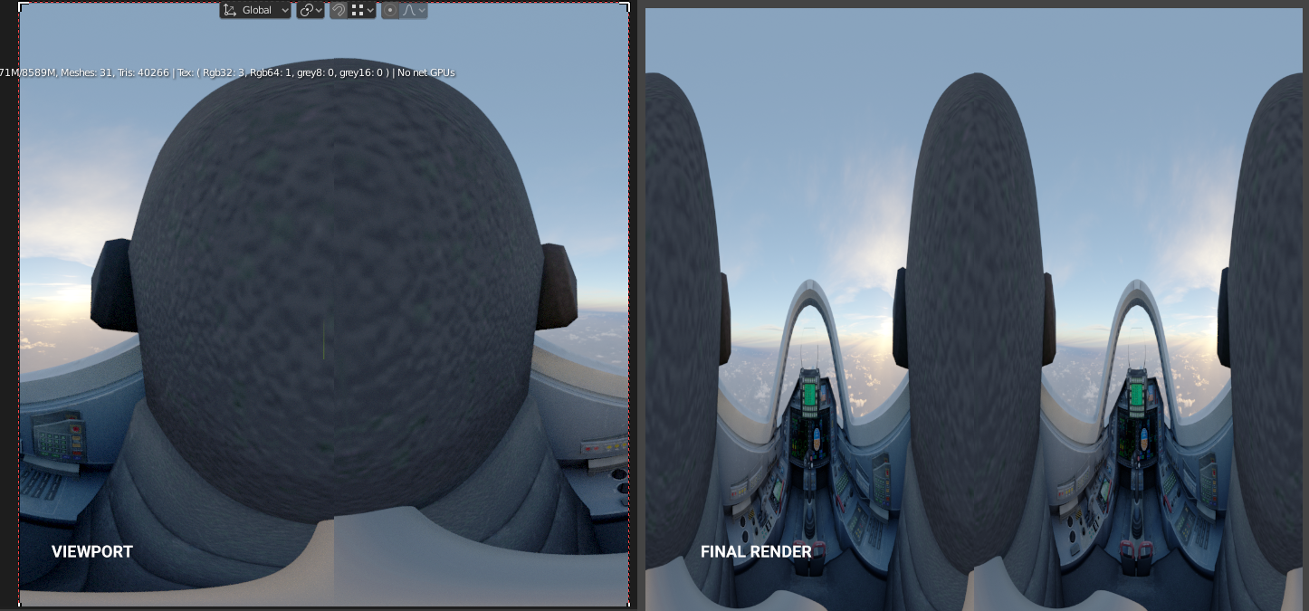

Panoramic images in look different viewport compared to final render. The differences are when Cube format and with Stereo output is enabled.

Camera is set to Panoramic > Spherical mode, Stereo output set to Side by side:
Camera is set to Panoramic > Cube map:
If you maximize the viewport to full screen it looks same as on final render, but when the view is scaled down it is cropped as on the examples above.
