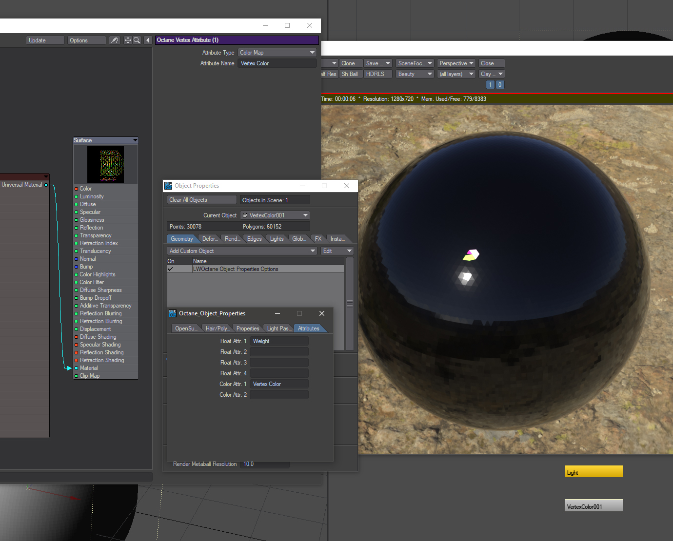

Thank you - I used the Object Properties to extract the name for the map as described, and as you can see on my attached image. Something's strange though, since the ball turns up black except for a few triangles with bright color.

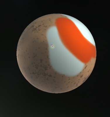

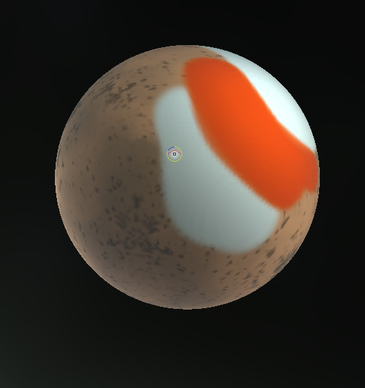

I have attached screenshot of how it looks when loaded into 3d Coat for vertex paint.
Any idea why it turns out the other way in LW Octane?

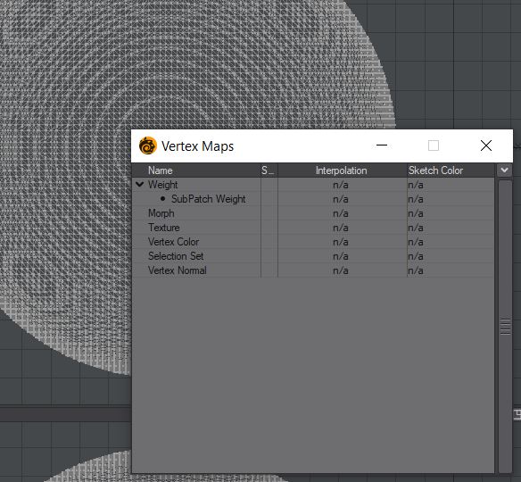

Hmm, but this object doesn't have any color vertex map! Have you been able to render the vertex color map using the LW native engine?

Yes, but LightWave seems to don't import this vertex color. Can you see it in the Modeler vertex list window?
Thanks,
-Juanjo
GimbalLocked
Posts: 13
Joined: Mon Mar 26, 2018 12:41 pm
juanjgon wrote:Yes, but LightWave seems to don't import this vertex color. Can you see it in the Modeler vertex list window?
Thanks,
-Juanjo
No, it's not there. Then I guess it's not an Octane problem - thank you for your time.
