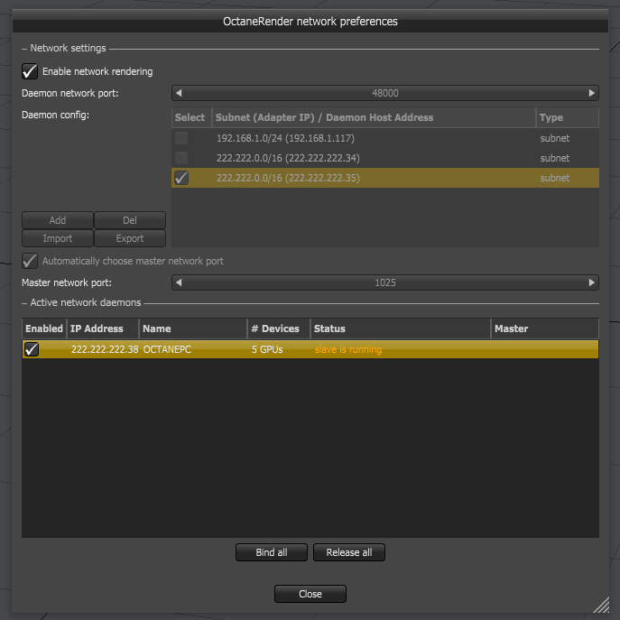

I have two local networks, the one 222.222.222.35 is my 10Gb network, but for some reason, though I have this ticked in the master, the slave is looking at the wrong IP.
My guess is it's not getting the full joys of the 10Gb network and is using the other network that is slower 1gb as I'm not seeing much in the way of speed boost when rendering.
If I disable the network for the slave so it only has the 10gb Network, it fails to work when rendering.

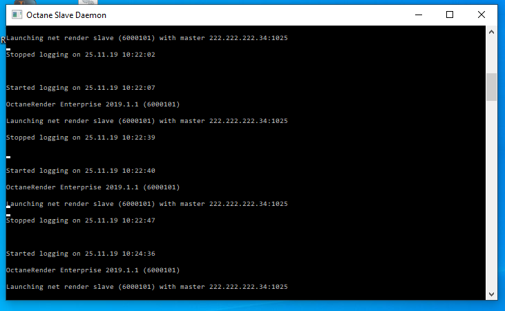

So it looks like when I pick the IP 222.222.222.35 it's ignored & still uses the 1gb network.
Also tested the standalone, same issues.

Found a workaround. I changed the IP for the 10gb network to 222.222.222.33 and now it picks that one for the slaves.
It looks like your choice is ignored & it picks the first IP on the list.
