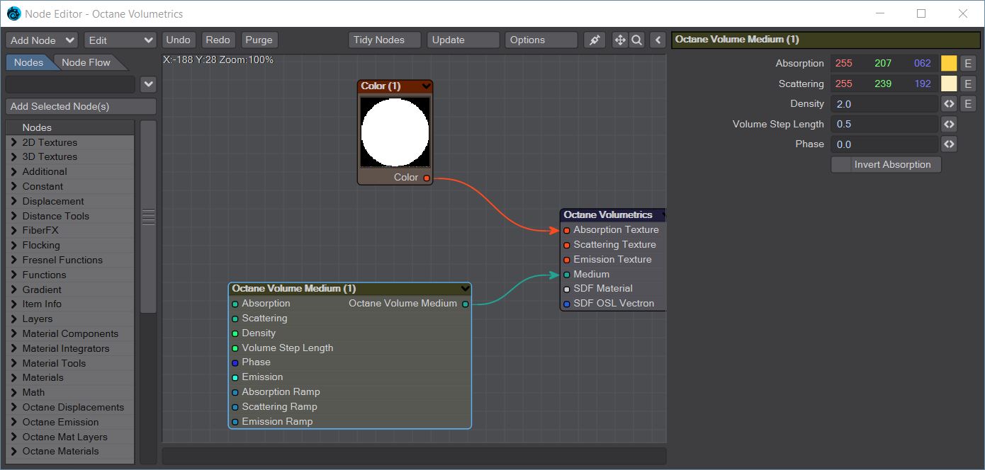

In the LightWave 2019.1.4 plugin, the "Octane Medium" group does not seem to include a "Volume Fog" node like there is with the Cinema 4D plugin.
I'm trying to follow this tutorial for creating a planet with an Octane fog volume atmosphere:
https://www.youtube.com/watch?v=4OYR8MCI_xw

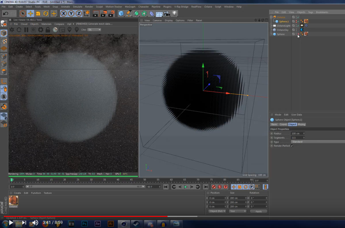

At 3:41 in the video the artist shows how the OctaneRender plugin for Cinema4D can make a sphere-shaped fog volume that wraps nicely around the planet with nice fuzzy blurred edges. He makes the fog sphere slightly larger so that the planet fits inside:

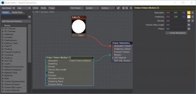

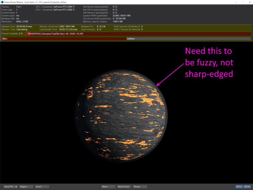

But when I went to the "Octane Medium" group in the LightWave node editor, there is no "Volume Fog" node. The only options available don't seem to work the way that the Volume Fog node works in Cinema4D. And when I try to apply one of the volume nodes that is in the "Octane Medium" group to a sphere with a specular material (this seems to be the only way to get the LightWave volume nodes to work), I get a hard edge on the sphere.
Is there a technical reason (e.g., a limitation of the LightWave SDK) why the Cinema4D Volume Fog medium is not available in the plugin for LightWave?
Thanks.

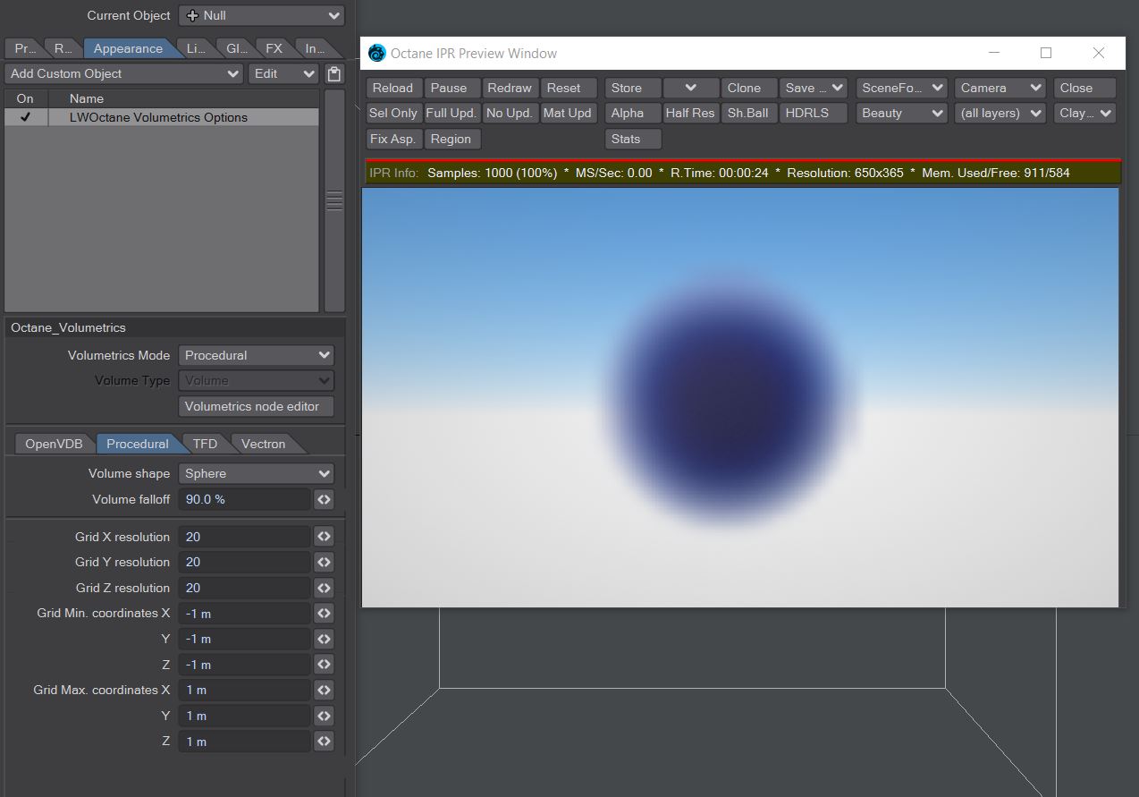

In the LightWave plugin, you have a custom object plugin to configure all the Octane volumetric features. In a null object, you can create a procedural volumetric object from a cube or sphere shape, that later can be configured inside the volumetrics node editor. Attached you have an example scene.

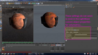

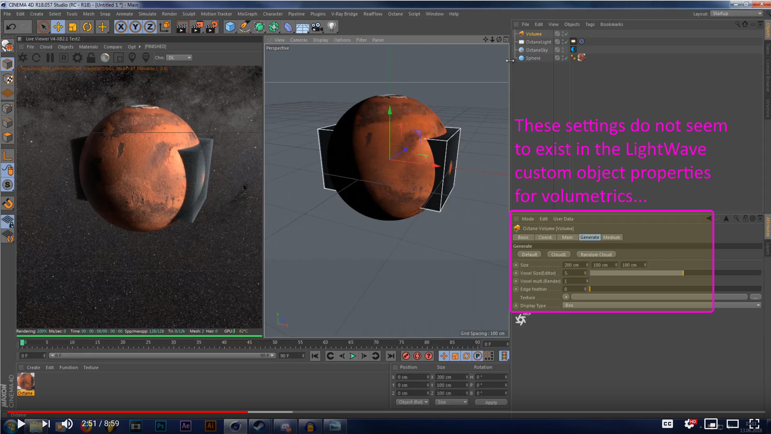

One last thing: you did not answer my question about the Volume Fog node, which appears to be quite different in LightWave vs. Cinema4D.
This is from 2:51 in the aforementioned video (https://youtu.be/4OYR8MCI_xw): Even after digging through the custom object properties dialog box in LightWave, I'm still not finding some of the settings that are available in the OctaneRender Cinema4D plugin; they just simply don't seem to exist in the LightWave plugin. For example, where do you control the edge feathering of the volumetric medium in LightWave?

This is not an Octane native feature. The volume fog object is something done on the plugin's side, so each plugin has its own workflow and parameters. In any case it is near the same. You have the size (that in LW is configured using the grid coordinates min and max parameteres), the voxel size (that in LW is configured using the grid resolution), the edge feather (configured using the volume falloff), etc.
Be aware that the plugins only can match the Octane native features, but there are a lot of tools added on the plugin's side that are not available for all the plugins, or they don't have the same features.
