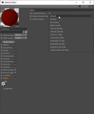

Use a smaller resolution for opengl previews for edited material

where do I set that Aoktar?
Posts: 16068
Location: Türkiye
mitchino wrote:where do I set that Aoktar?

Thanks, I normally set that to 16MB for detailed texture elements, type, logos etc. Good to know I can speed things up by turning it down.
