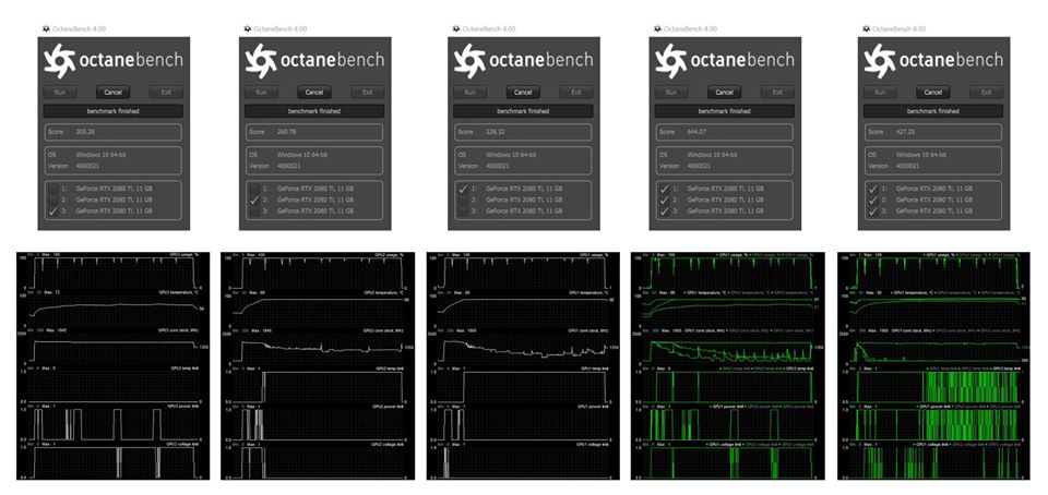

Another thing to mention, if that is not obvious, keep an eye on temperatures during rendering. In some cases You can loose a lot of performance, like pointed in this post:

Thank you for your response.
Latest drivers, clean install, studio drivers
result : 144,48
here are some screenshots of the settings and results:
https://imgur.com/a/XhIS0eN
see anything wrong?
thanks in advance!

Hi dbmd,
The GPU-Z temperatures and load look very consistent, no throttling or issues there. Only thing that stands out to me is the PCIe bus speed which is at x4. I believe this should be x16 which enables higher bandwidth between CPU/RAM and the GPU, but, I'm not sure if it is a factor in the process since i'm no expert on how this rendering stuff works in regards of data exchange between those components.
We'll have to dig a little deeper
Regards,
