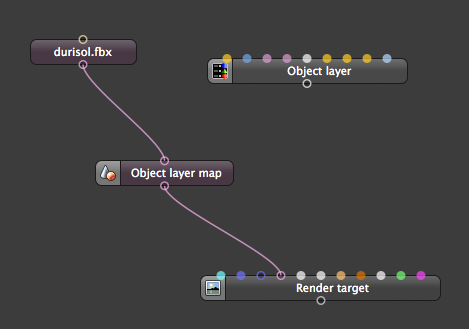

I'm trying to bake some quick textures for unity (without unity addon, just normal octane standalone). I'm using version 2019.1.3 and I just realised that my object layer map misses the input for an object layer. I can attach a geometry node, but that's it. is this a bug?

See if you can go in the import settings of the geometry node from the Node Inspector, change the "Object layers" option to "Single pin for all object", and at the bottom activate the "Load object layers" option. This should create an Object layer pin directly on the geometry node.
