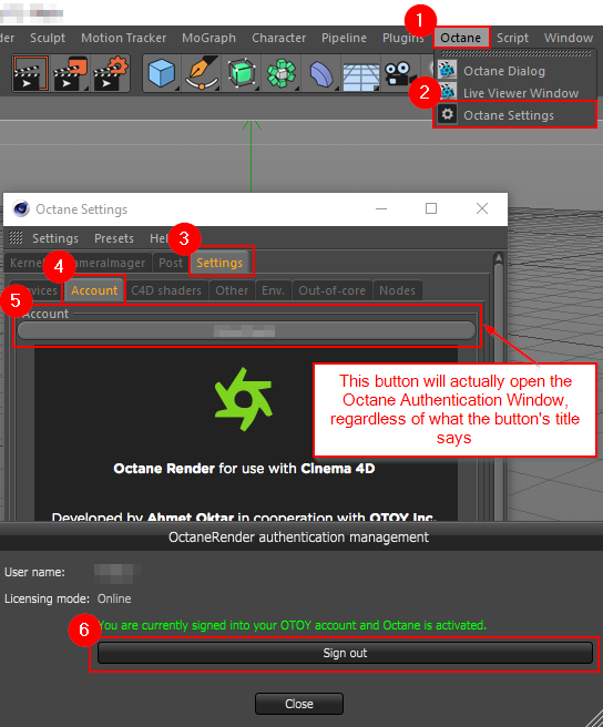

In the active machine, please go to Account panel, and press the sign-out button, to deactivate your licenses, here is an example from C4D:

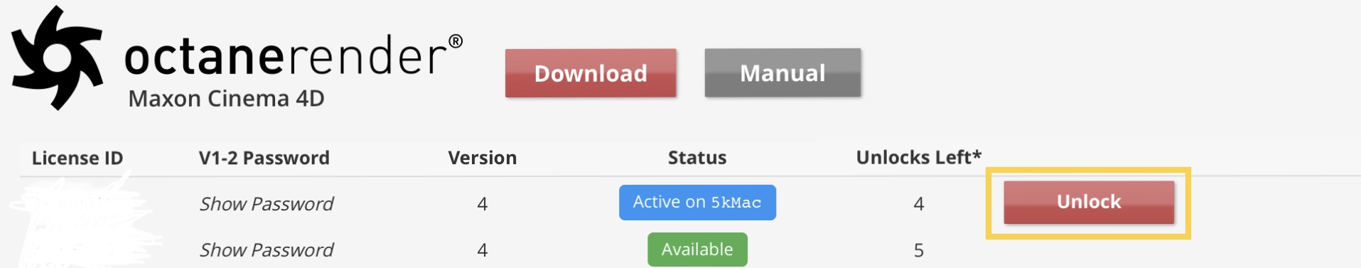

If you cannot manually deactivate your licenses, you need to use the web deactivation by pressing the red Unlock button beside of both Standalone and plugin licenses in the OctaneLive page:
Please note that the web deactivation should be used only if the active machine is no more reachable, or if the manual deactivation doesn’t work.
Please also note that the web counter will be reset to maximum after a certain period of time, if the unlock button will not be used during that time.
