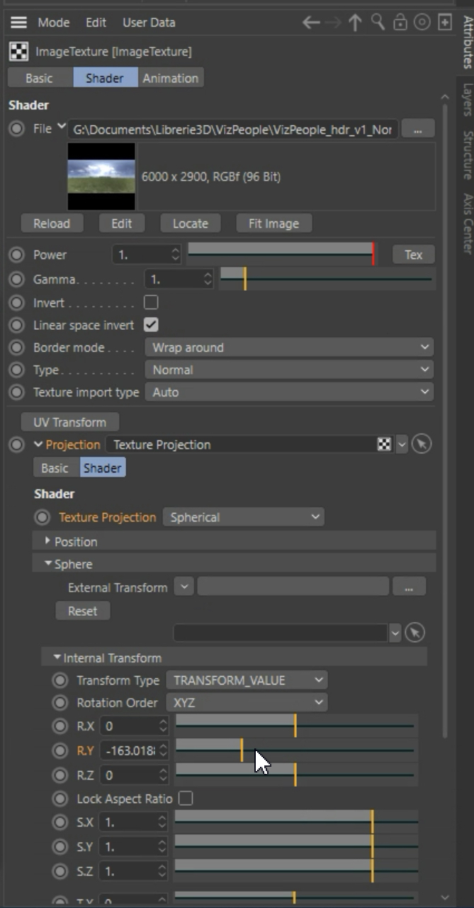

I use hdri envirovment, then add CC and after cant rotate HRDI. Its very big problem for me, how to fix?
Posts: 10449
you need to navigate inside the ImageTexture node, change the Texture Projection into Spherical, and change the Y rotation:

Fuh... All work. But is was hard. Not user friendly(
First i need find this, then change to Spherical and then its work. But thx for help! Was important
