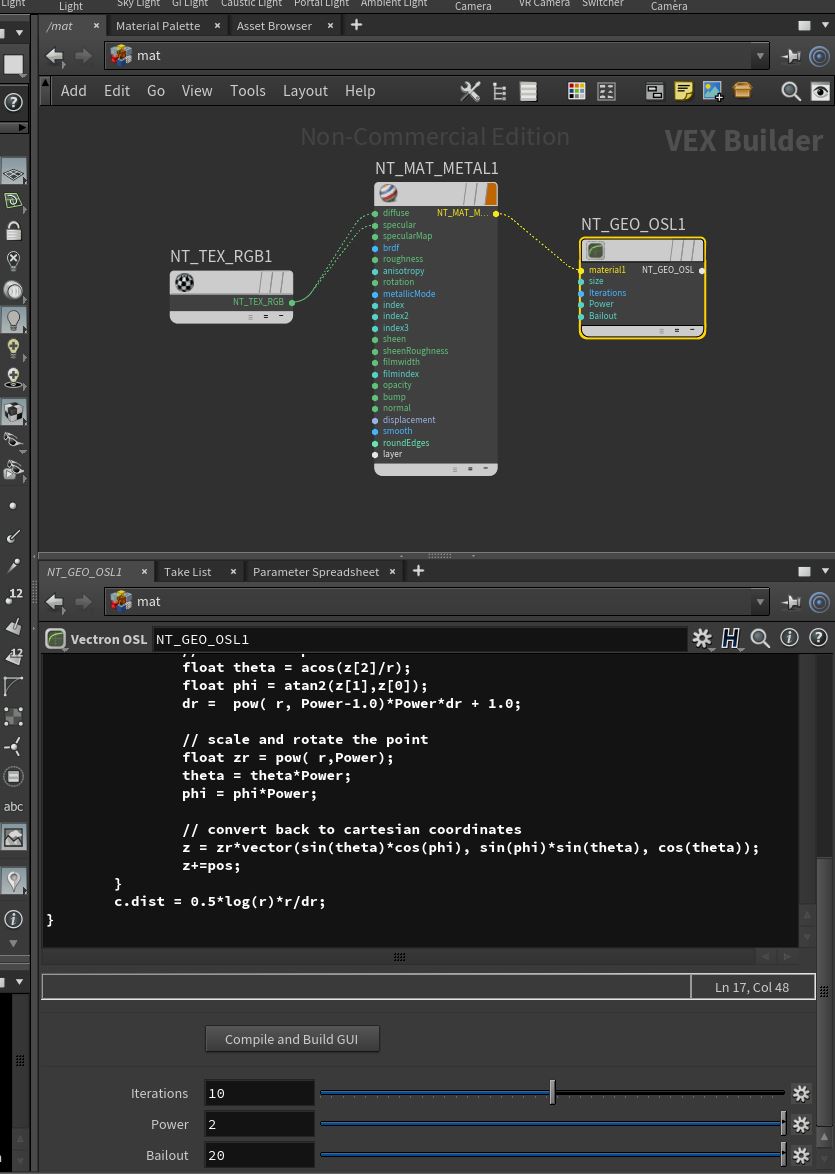

In C4D this is fairly simple to setup, but how can I create a Mandelbulb Vectron in Houdini, where do I get the code for this? Is it even possible if I have no knowledge of OSL?

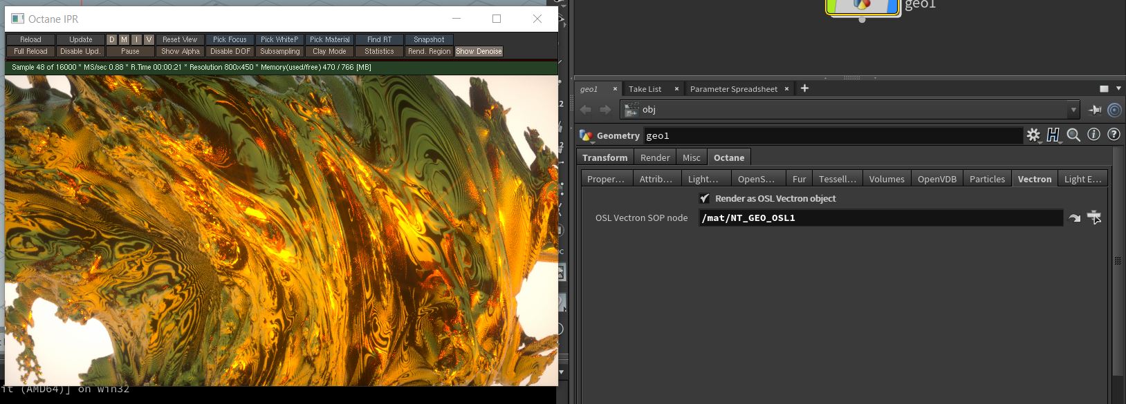

The Vectron objects in Houdini are configured adding an OSL shader with the OSL code to the vectron options available in the OBJ spare parameters. Attached you have an example scene if you want to take a look at it.

I recently switched from Lightwave to Houdini, and was happily surprised that my collection of Vectron formulas works without any change.
So, if you are looking for formulas, you may have a look here: https://github.com/thargor6/FFVectron

I've tried in Houdini, but how can you specify the path to ff-vectron ?thargor6 wrote:Hi,

It's a bit of a mystery, it works on my machine (without any obvious changes to settings ), but I can not duplicate it.davidyannick_1 wrote:thargor6 wrote:Hi,
thanks
But, I have found a workaround: You can use absolute paths. It is not really nice, but it works: just edit each formula you want to use and exchange the "ff-vectron-h" by the actual path to this file on your hard drive.
(It is at least a lot better than copying the contents of the ff-vectron.h into each formula, which also would work).
