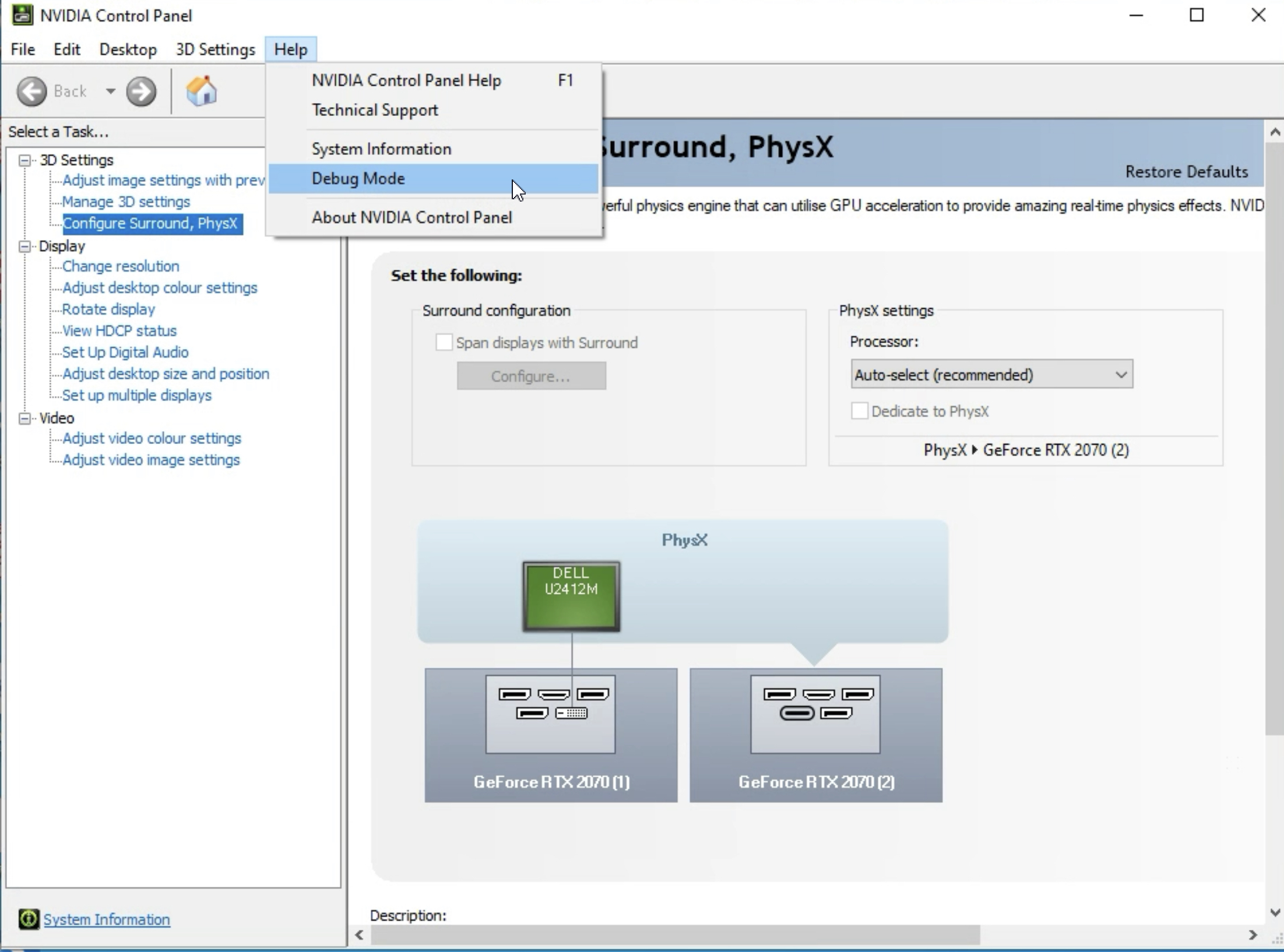

If you are still having instability issues, go to Nvidia Control Panel menu Help, and enable the Debug mode: ciao Beppe
