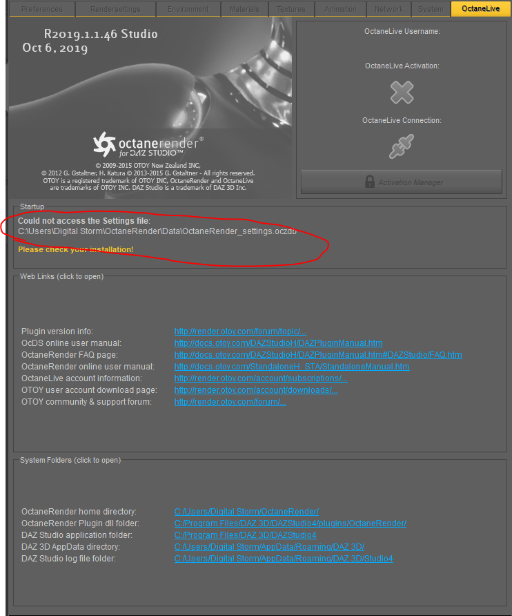

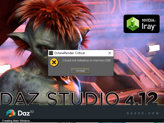

I am running into an issue where octane render gives me an error everytime i launch daz. This doesnt matter how i install/reinstall/uninstall/install with DIM DAZ, i tried reinstalling daz on a different hard drive and it still gives me this error. Octane then gives me this error after i press okay saying that it cant access a file in a certain location that it lists, which i then go to and I CLEARLY SEE THE FILE THERE. what is going on here?
here is what octane main panel says when daz is launched:
i also re-installed daz for octane twice and it didnt solve the issue. Does it have to do with daz standalone or something?

Hi. May I suggest deleting all files and folders under C:\Users\Digital Storm\OctaneRender\Data (and delete the Data folder itself). Then reinstall the plugin a see if that resolves the issue. If not, I suspect you do not have write access to that folder.

i have the exact same problem ...it's says that the file cannot be accessed but i can even edit it in file manager ...
so what did you do to fix this...?

ah....just delete the offending file and octane will create another one that now works....!!
