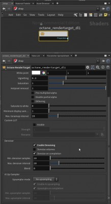

All the denoising options are available in the render target imager node and exposed in the included render target HDA tool, inside the Imager tab, as you can see in the attached image.

2019-11-03 20_05_26-untitled.hip - Houdini Apprentice Non-Commercial 17.5.391.jpg

Thank you Juanjo, exactly what I was looking for.
