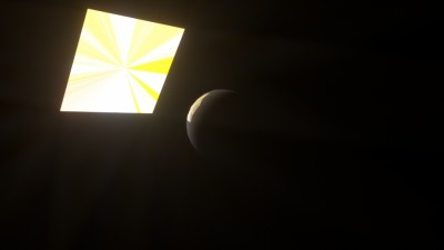

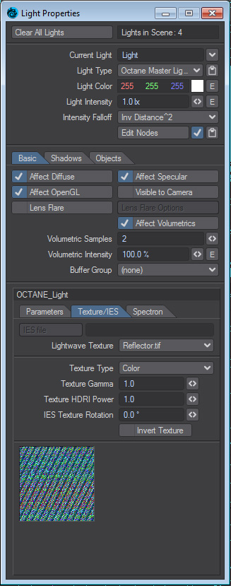

Is it possible to add an image to an Octane light so I can create a softbox effect which gets darker towards the edges? In the light options I've gone to the Texture/IES tab, chosen the texture, then Texture Type: Color but it doesn't map it correctly to the shape (see screengrab). It seems to need a projection node but there's no way I can see to do this.
Up til now I've been using a square poly and mapping the image to that and then made it into an emitter with the emitter node. This works OK but it's a bit clumsy to work with and also a couple of times I didn't seem to get the same clean result as a normal light.
Can anyone help? :)

The texture projection available inside the Octane lights is designed to support the IES files only. This spherical projection probably doesn't work for a plain texture map, as you have found. Currently, you need to use a conventional UV mapped object with an emission texture as material to render this effect.

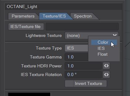

I have added this feature to the next plugin build. If you select a color or float texture type, the lights will work using a UV mapped shape to allow the use of conventional textures, while the spherical projection is used only if you select the IES texture type.
Thanks,
-Juanjo
