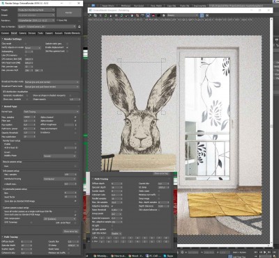

Hello,
The Render region renders for 4 or 8 seconds and pauses. Do you have any secrets? Any time limit settings? I've tried several settings. Film region works fine ...

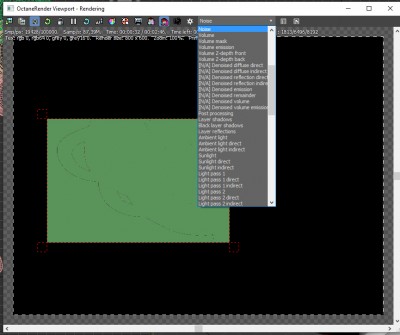

probably render reached max sample goal.
Try to check noise layer, is it green?
