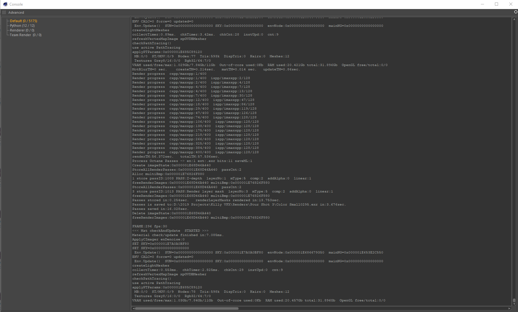

It happened again and I was able to grab a console screenshot as well, see below

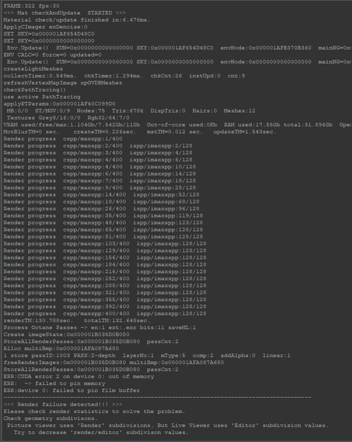

Joined: Fri Oct 23, 2015 2:37 am
I may have spoken too soon on this one. One of my renders worked fine, but I am still getting crashing partway through another project file, but this time I seem to be getting an "out of memory" error on one of my cards based on the log and console (see attached). I'll try the older version of the driver and see if that helps, but I am confused about the memory issue, as it looks like there should be plenty for my scene.
