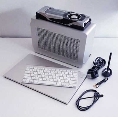

Here is a small box I got for myself, as a portable solution on the move. Screen connects via USB type C to get not only signal but also power. In this case I can upgrade anything: CPU, GPU, RAM, PSU, MOBO.. I started with smth simple 8700k, got to test 9900k, but ended up with 9700k (as it's enough). 32GB is present but will change mobo and add 64GB (usign 2x 32GB sticks) instead, also might switch GPU to RTX Titan from 2080ti (and 2070super that was before)..- You do not get this type of flexibility with any laptop. For me that is important because I can get what I need now and not to buy over build unit based on what I might need in the future.
* GPU ontop is only for size reference.
