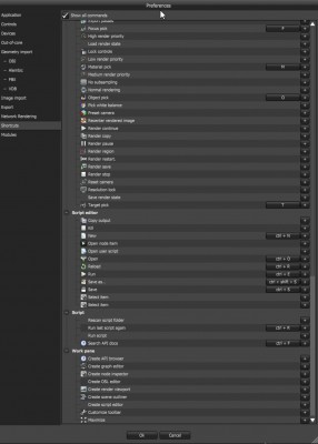

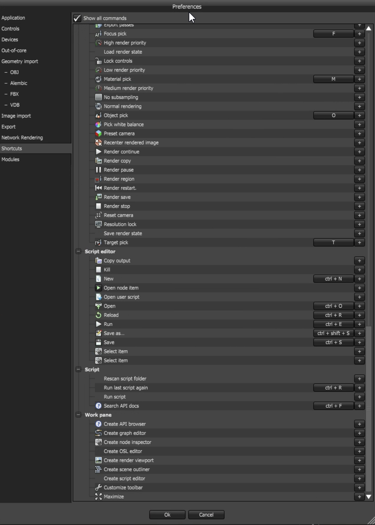

Posts: 10575
if you go to File/Preferences/Shortcuts, you can see which hot keys are already used, and which are available by default:

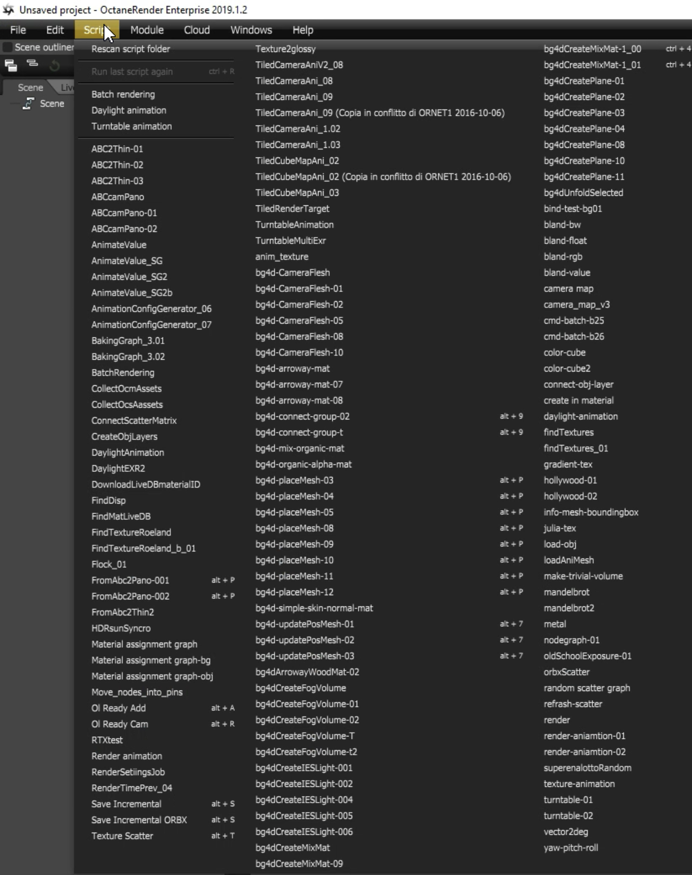

If you want to create specific nodes, or a specific workflow, you need to create a Lua script, and assign a shortcut to it:
