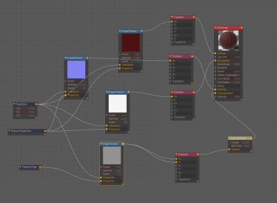

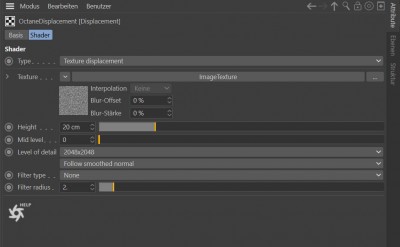

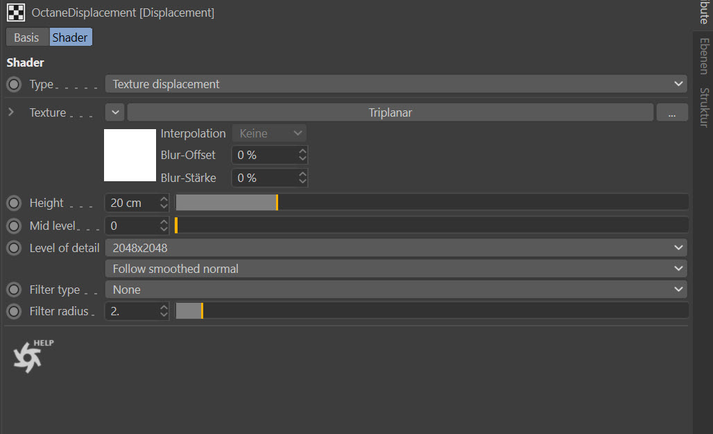

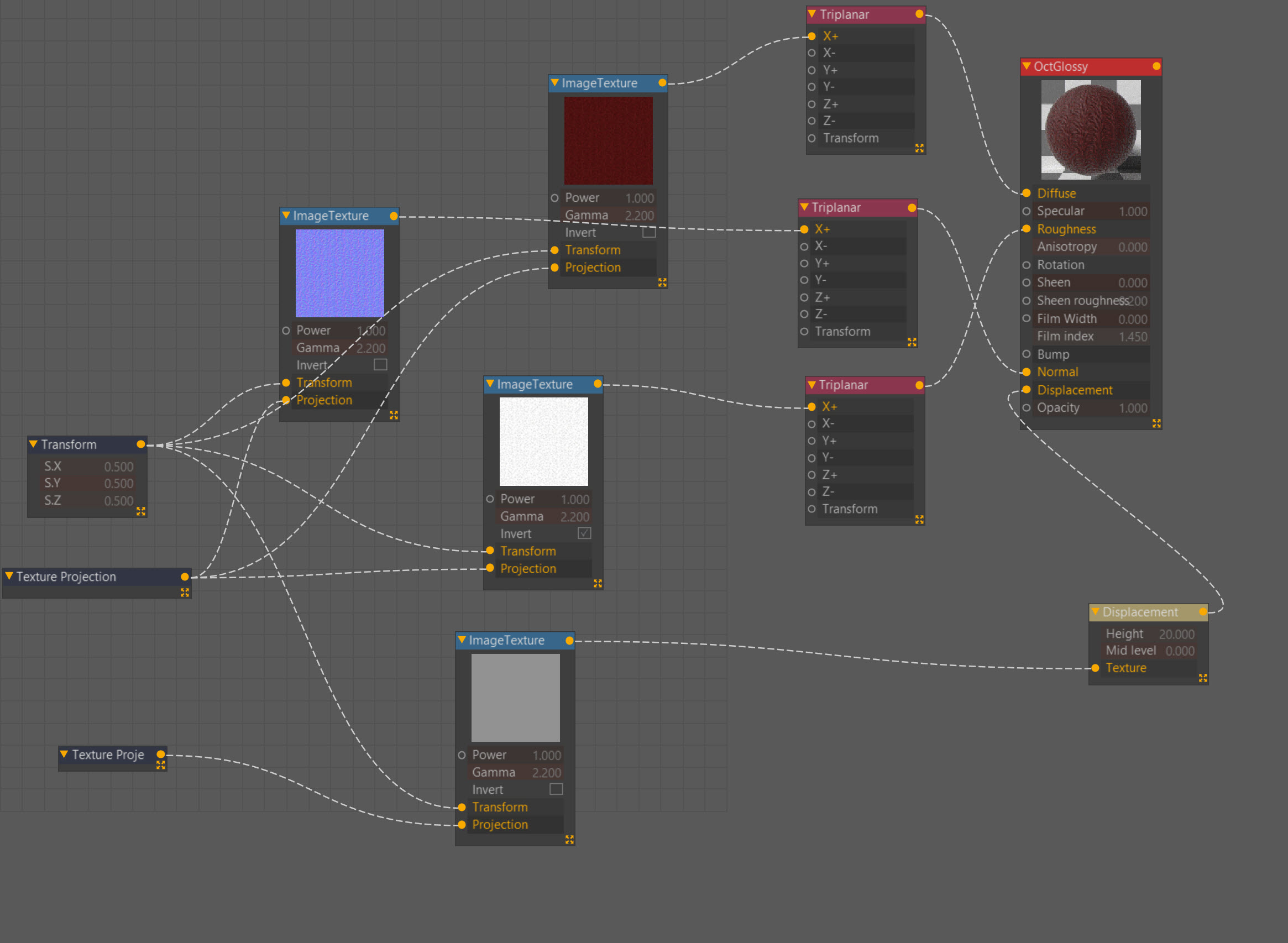

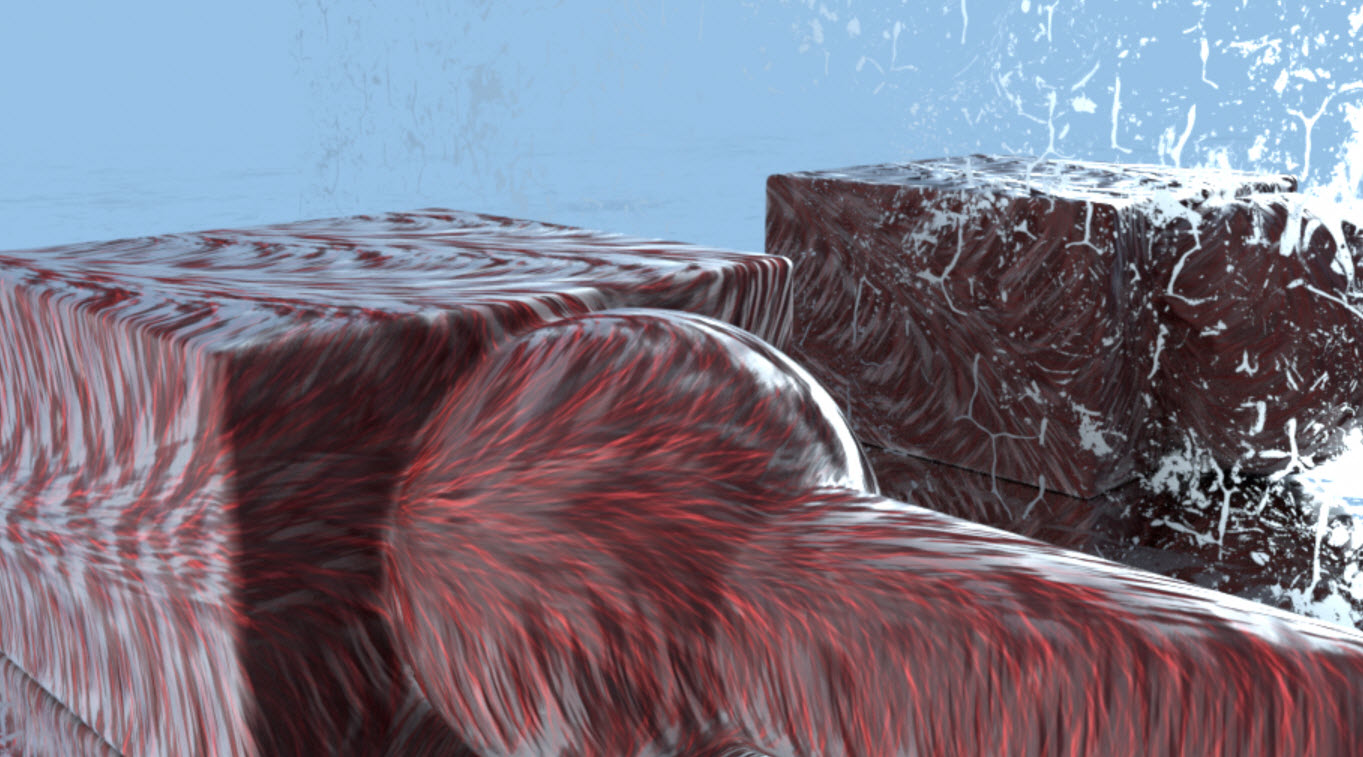

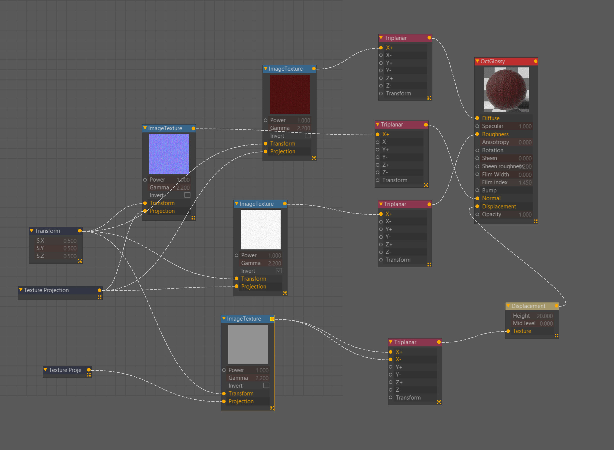

Hi frankmci,
thanks for your answer.
Oddly enough, the triplanar projection does not seem to work with the displacement. For clarification, I hung a few screenshots and the project file to the mail.
First example (first free pictures): Displacement without Triplanar = works!
Second example (last three pictures): Displacement with Triplanar = does not work (no displacement).
I use the 2019_1_2er versions (Standalone and C4D), had this phenomenon already in the versions before.
The projection is also set on Triplanar.
Korbobjekt.zip
(3.33 MiB) Downloaded 191 times

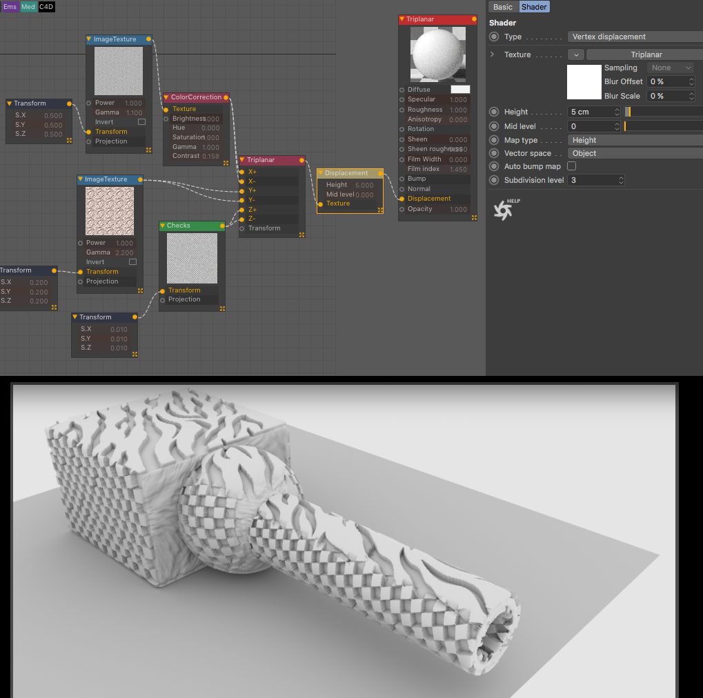

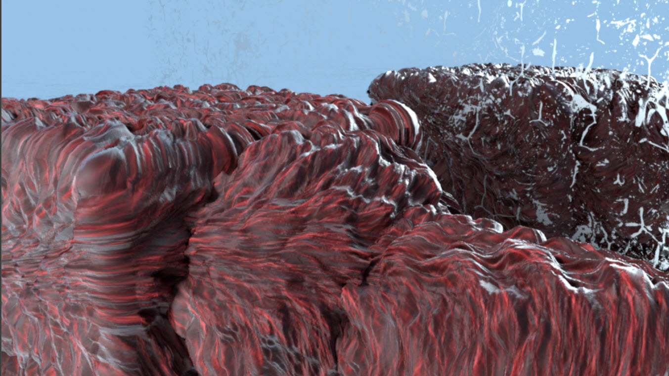

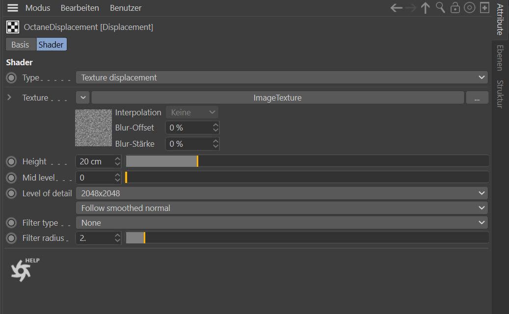

Ok, I think I see the problem. You are using the legacy Texture Displacement, which is still available for backward compatibility, but which has all sorts of limitations. Try switching to Vertex Displacement in the Displacement node, with Map Type set to Height. It is much more powerful and flexible.
Triplanar Vertex Displacement
Cyber-Steve
Posts: 26
Joined: Fri Apr 27, 2018 6:15 am
Yeah, thats it :D
Thank you so much !
