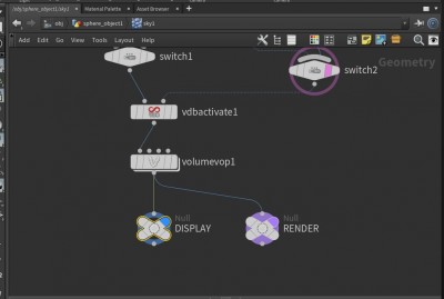

Hi I'm new to Octane. I am using the Sky rig shelf tool but I'm not able to see it in my render at all.
I have no problem rendering volumetrics from cloud rig but somehow the Sky rig is not visible in render.
Any help will be appreciated.
/Nikolaj
juanjgon
Posts: 8867
Location: Spain
For an unknown reason, the sky rig sop has the render output node disconnected. This is why Octane is not rendering the volumes, it always extracts the render sop, and in this case, the render sop is only an unconnected null. To fix this issue, you need to allow the editing of contents in the sky sop and wire the volumevop output to the RENDER null output, as you can see in the attached image.
Thanks,
-Juanjo
TheNikand
Posts: 32
Joined: Mon Jul 11, 2011 11:09 pm
Wow thanks Juanjo, this was driving me nuts!
