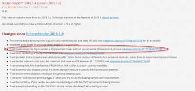

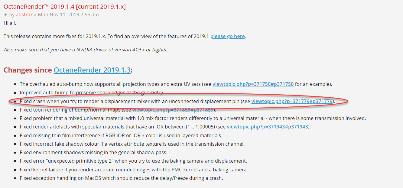

People are not aware of that I'm not support stuff and not a part of OTOY. Just doing out-source for c4d plugin. This is most important part for me! I'm always trying to fix/improve the stuff on my side. And there's not any other way to improve a software, you do same for Maxon or other companies: Reporting bugs and they fix. Every C4D builds have many fixes after these reports.
Other than this, after my test that displacement mixer seems like crashing on material previews. Probably it's what write in picture, not a c4d issue. And last, which manual are you talking about? C4D manual is huge and most complete manual on Otoy universe. We try to add missing part when we finished new features.
