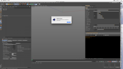

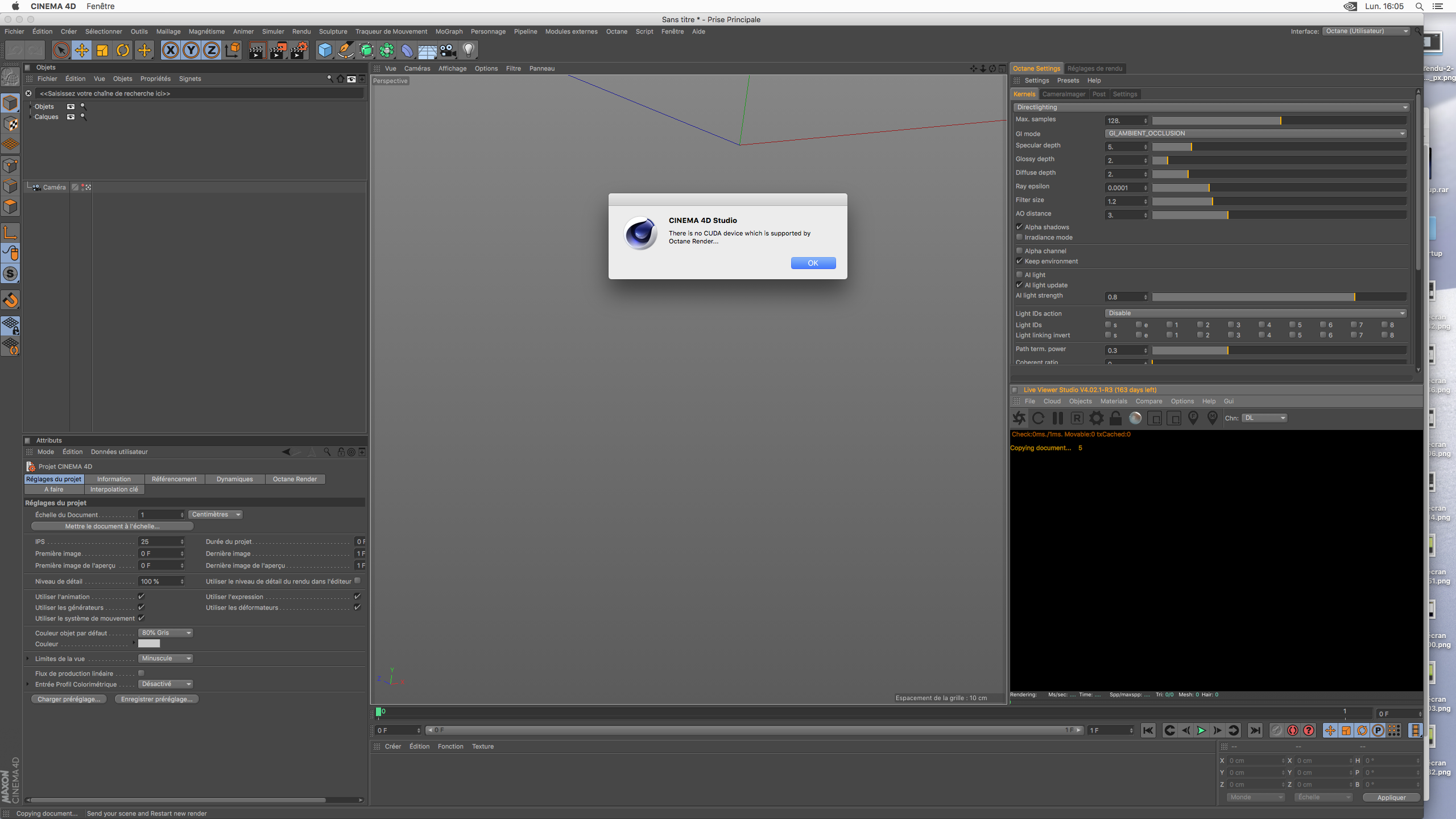

I've been using Octane for Cinema 4D on Mac since March 2019, and so far everything was working fine.
Since today Octane no longer recognizes the Cuda driver.

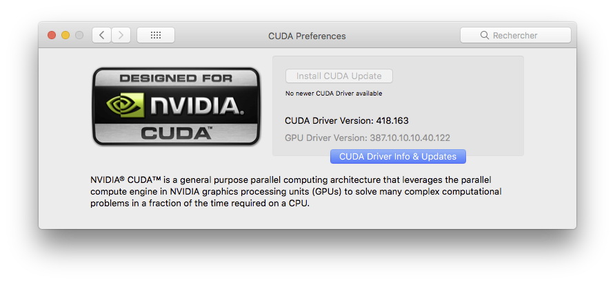

I just updated the Cuda driver but it did not solve the problem. Could you help me please ?

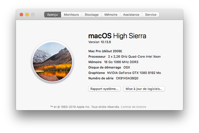

Mac OS version : 10.13.6
CUDA Driver Version : 418.163
Octane Render version : v4.02.1-R3

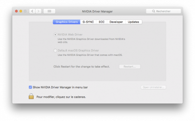

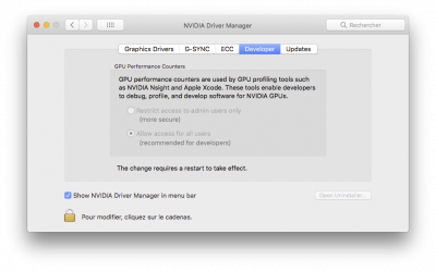

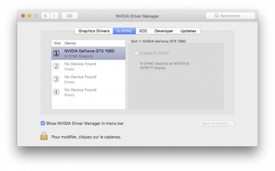

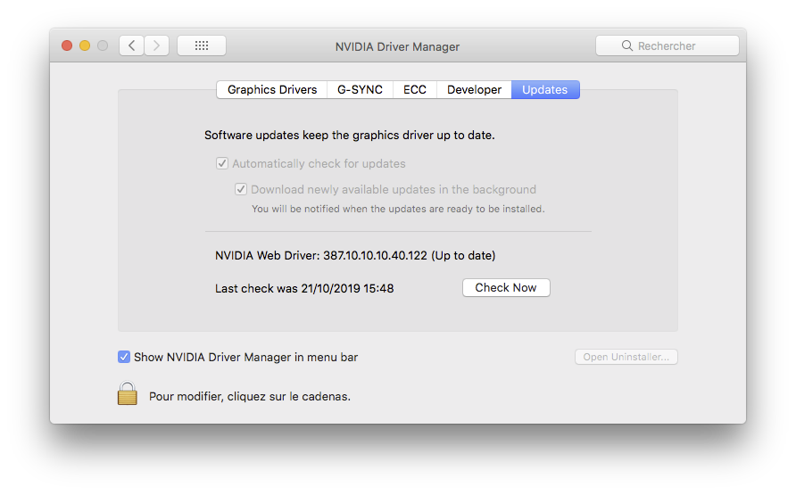

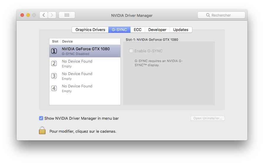

I post screenshot for more details
Thank you in advance for your help,

have You updated Your OctaneRender?
if so, when changing version of program, check what drivers are recommended as well
"-Updated Nvidia drivers at least 388.xx, recommended 417.22 or 419.17 (one of most recent with Cuda 9.1) and be carreful with latest drivers which can cause cuda errors. Avoids to use 418.81.
-Cuda 9.1 driver for OSX." - that's from viewtopic.php?f=85&t=70622 (if this is the version You use)
