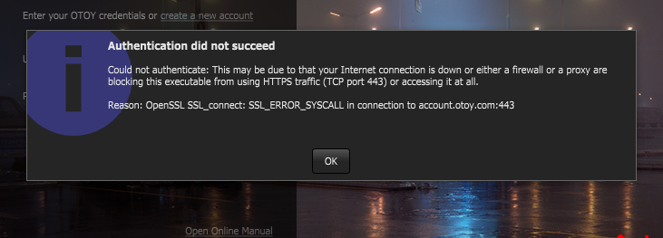

I've been getting this error: Cannot Authenticate: This may be due to that your Internet connection is down or either firewall or a proxy are blocking...
REASON: OpenSSL SSL_connect: SSL_ERROR_SYSCALL in connection to account
//On a side interesting note, doesn't matter what password I'm typing in, it still give that error so I'm guessing something is not connecting correctly?

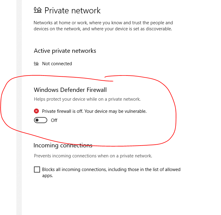

- Switch firewall off

Firewall OFF
Firewall OFF
Error
Error

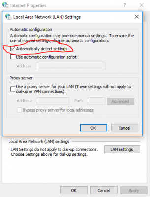

OK, I've figured it out, thanks for the advice @bepeg4d
All I did was:
1. Internet Options
2. Click on Connections Tab
3. LAN Settings
4. Automatically detect settings (mine was on "use proxy server for LAN...')
Also, I used wifi instead of the network but I don't think that would have an issue?

From the error code shown in your screenshot and your later note about removing a configured proxy server,
the likely cause of your issue would have been a proxy that was attempting (and failing) to MitM the SSL connection.
