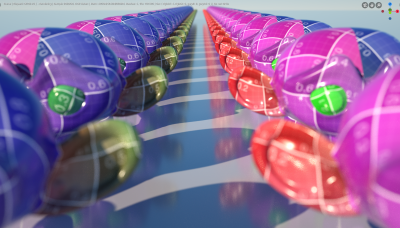

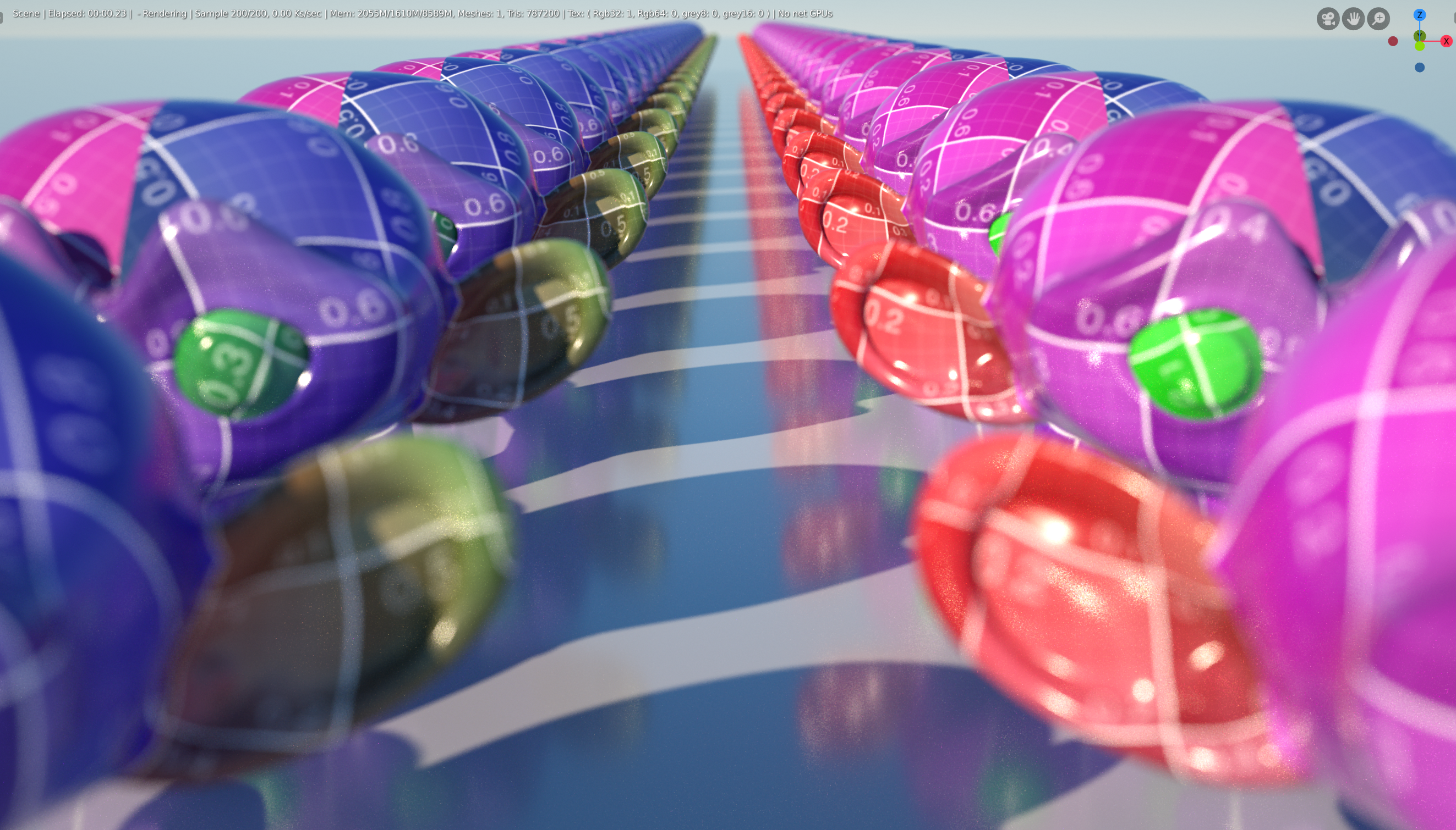

When I use an object to focus on and set F_stop to a low value I can see the effect in preview rendering, though not that strong...
When doing a final render it shows fine then....
Two screen shots with F-stop set to 4:
Final rendering
Final rendering
Preview rendering
Preview rendering

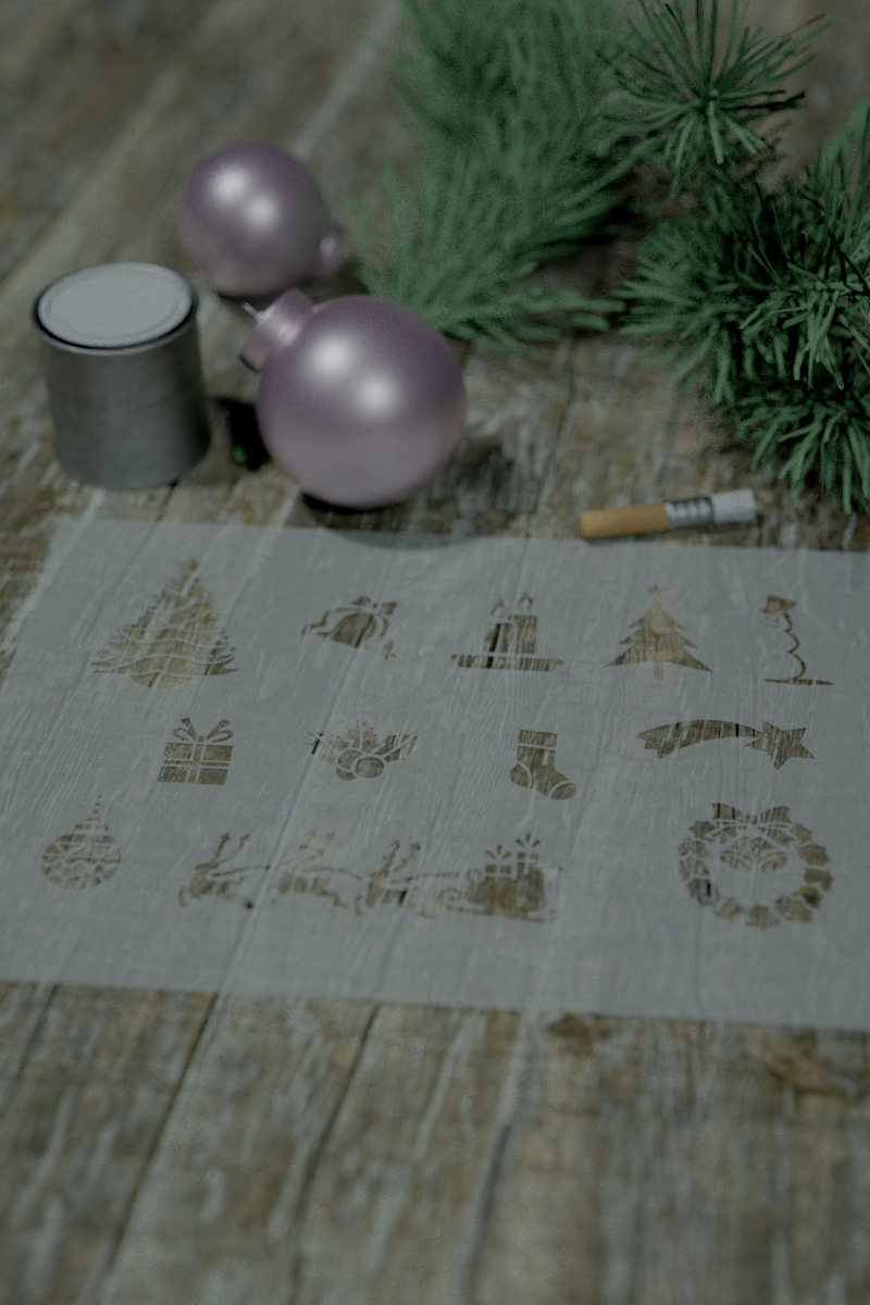

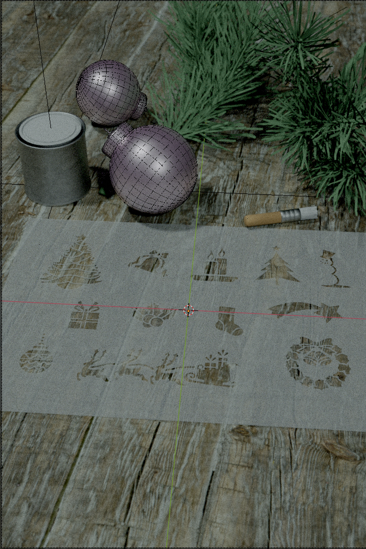

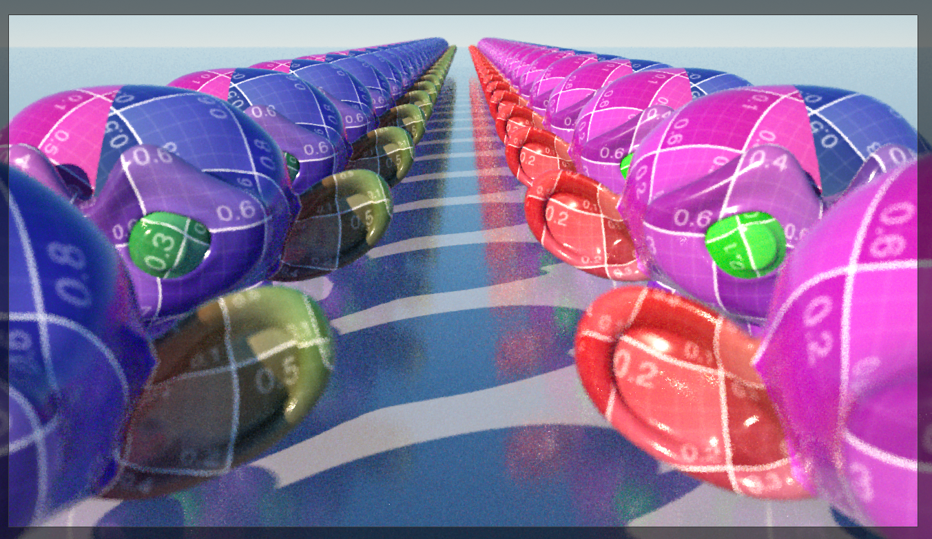

The DoF in the viewport depends on the "zoom" of the view. So if you zoom out the DoF will be larger ("less blurry").
To get it as close as possible to the final result you can move the "A(window) rea borders" so they match the image view.
All settings (F-stop, FoV/Focal Length) are the same in the images, only changes are the "zoom" in the view. (Notice the difference on the "0.2"/ear).
"Camera view" is smaller than the window area
Camera view borders matches the area
