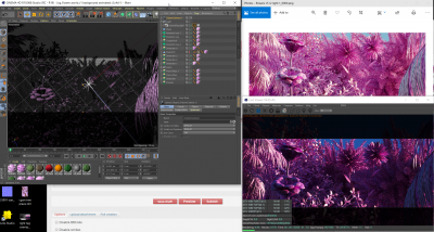

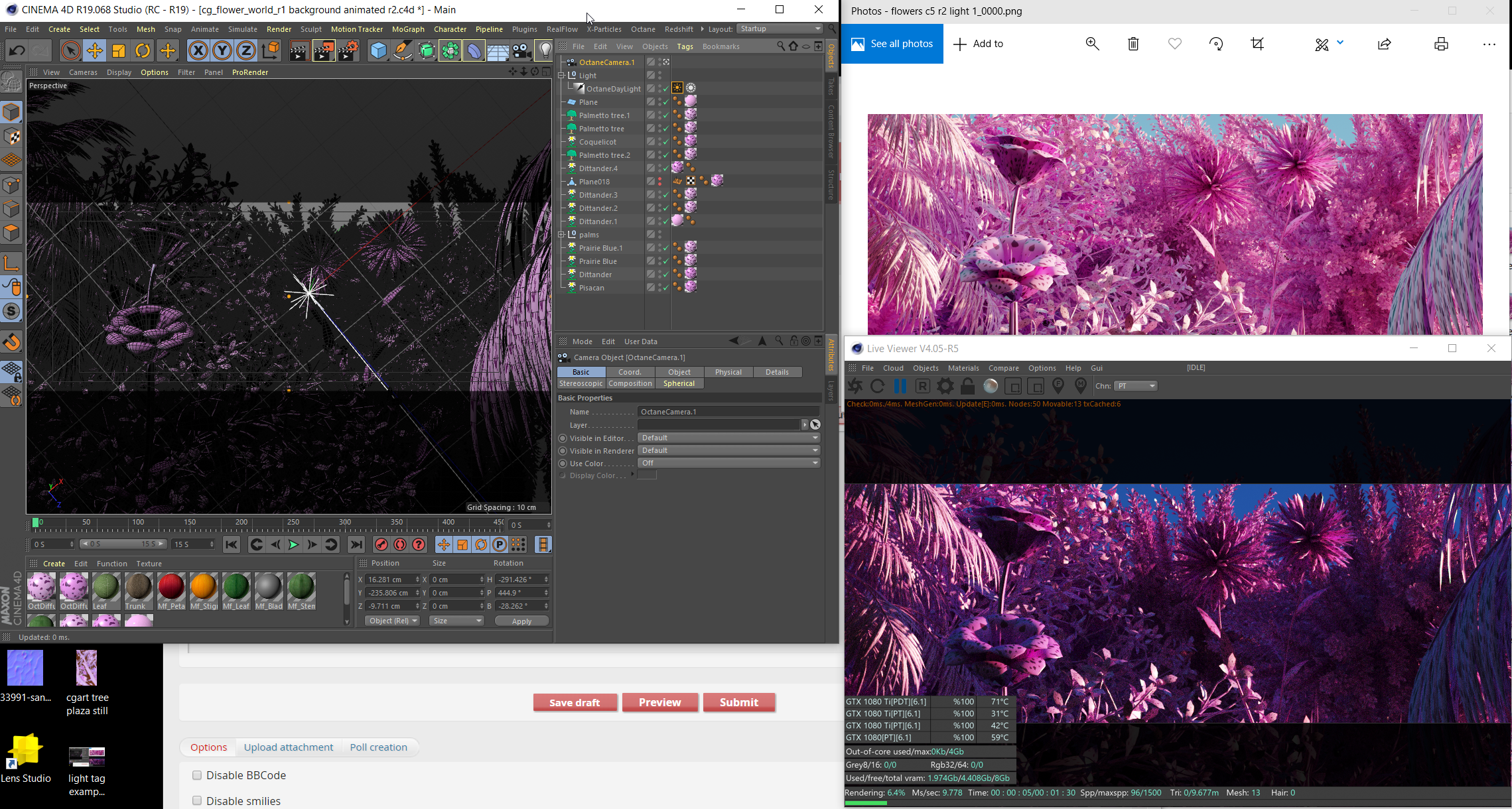

Just updated to 4.05 R5 from 3.07 using the octane daylight tag in my scene. When I reopen my scene with 4.05 r5 version. The lighting shows up incorrect. Please see my screen grab that shows my original render from 3.07 in the upper right hand and the new result that shows up in 4.
Is there a way to adjust this to reflect my settings from 3.07?
Just a note. I get the same result even when I select "old daylight model" in the tag settings.

Needed to use another response other then Srgb in the Cameralmager Imager panel
