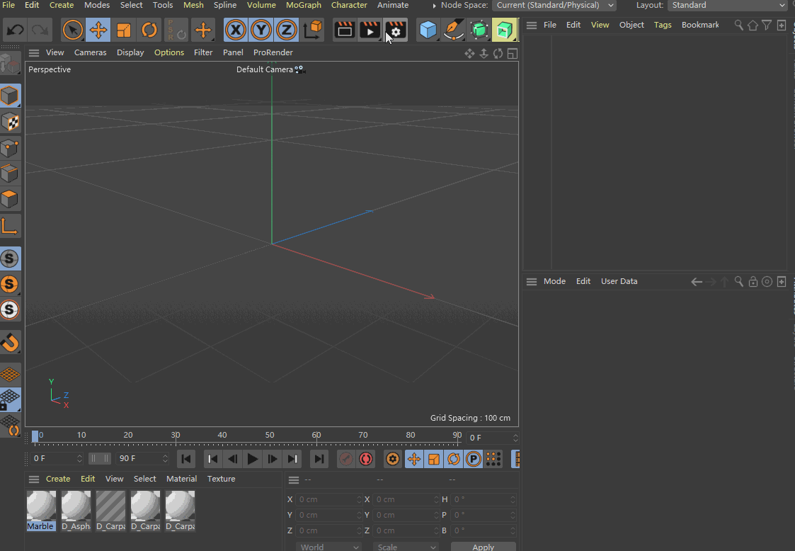

the problem is LocalDB textures is still missing after i save scenes in R21.022 RC
can you tell me how to fix this ?
the demo gif of problem is up to attchment
thx a lot

There was a bug which creates a material layer and cover the result.
Latest build will fix it.

It was not a problem about missing textures. Just extra material layer node and it hides the material's output.
