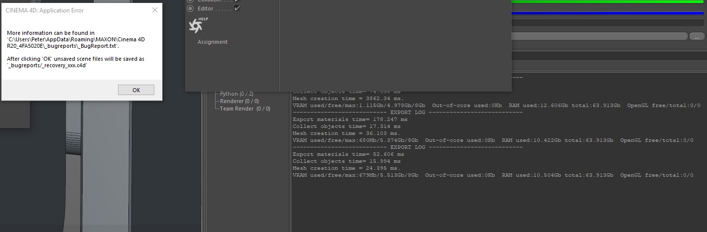

I get this in the console when starting back up from the crash
