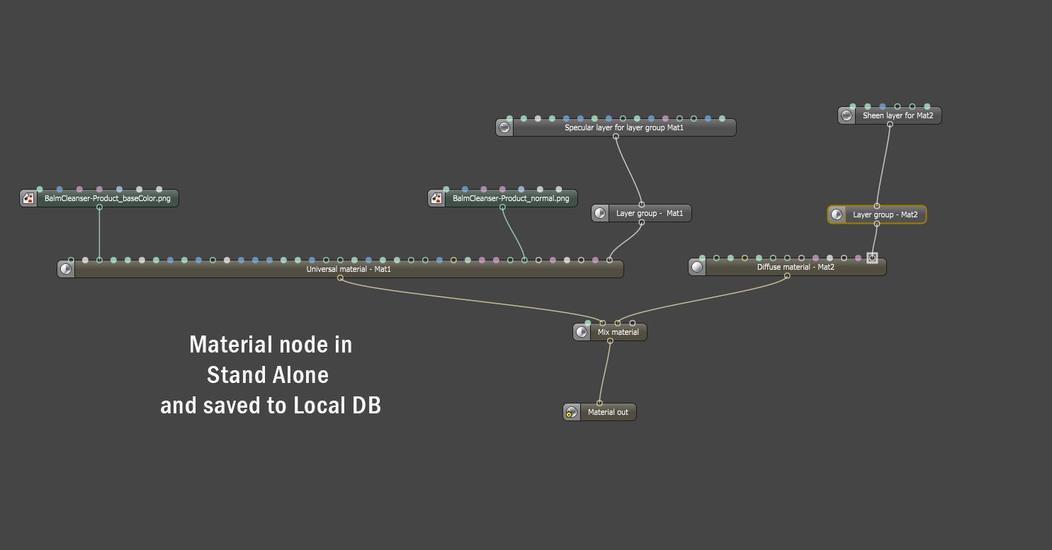

Material from Stand Alone - saved to Local DB:

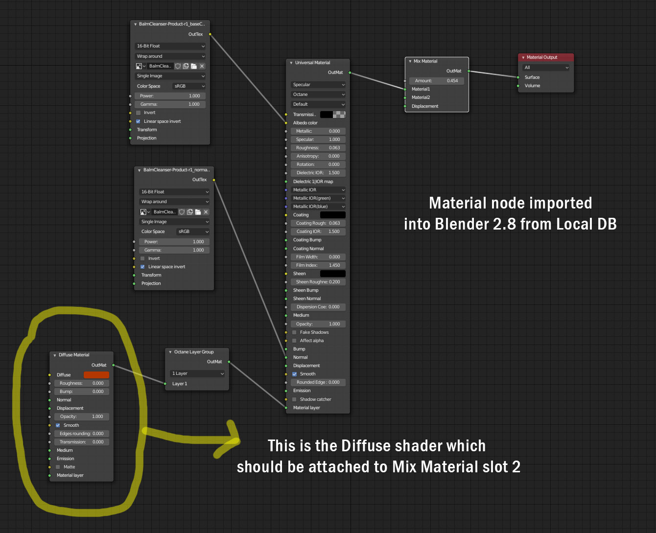

Material imported into Octane Belnder from Local DB:
