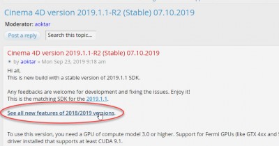

Hi, I'm a bit confused as to which Octane version I should be downloading. What is the difference between 2019.1 and 4.05? I'm using R20 C4D.
Posts: 16068
Location: Türkiye

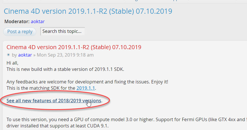

See picture

aoktar wrote:See picture
And what is the answer? This is not a very helpful answer. Because I used 2019 and I had some issues and version 4 was stable. Also if you look at the plugin number it is kind of confusing. 2018 versions, then version 4, then 2018 again ending with 2019.

version 4 is old version.
version 2018.x is internally version 5
version 2019 is the most newer version.
The answer aoktar gave you is not a bad answer, there are a big number of changes between versions, there is a lot of information in the forums about the changes between them in each main post.
in each plug in release aoktar shares a number of links with this information, documentation, also provides a list of changes between the versions and sub releases.

omardex wrote:Hi,
Thank you helping me out! Hopefully, everybody doesn't expect me to be a support guy from a developer. Explanations are in the link as you said and I cannot give answers in-depth for every question. I'm just trying to give quick tips to where to look. I'd not work on plugin if I do that.
