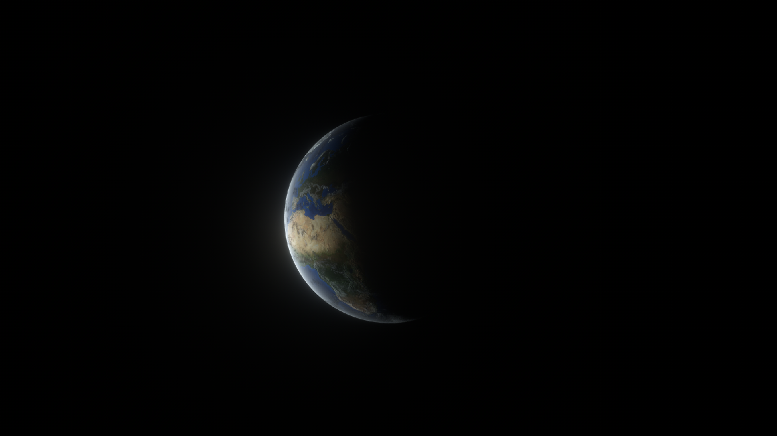

I'm using octane with cinema 4d but I am experiencing a problem.

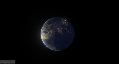

When I render with the live viewer (capture1) for testing material I get that render

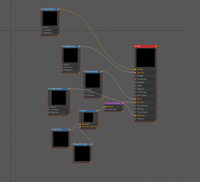

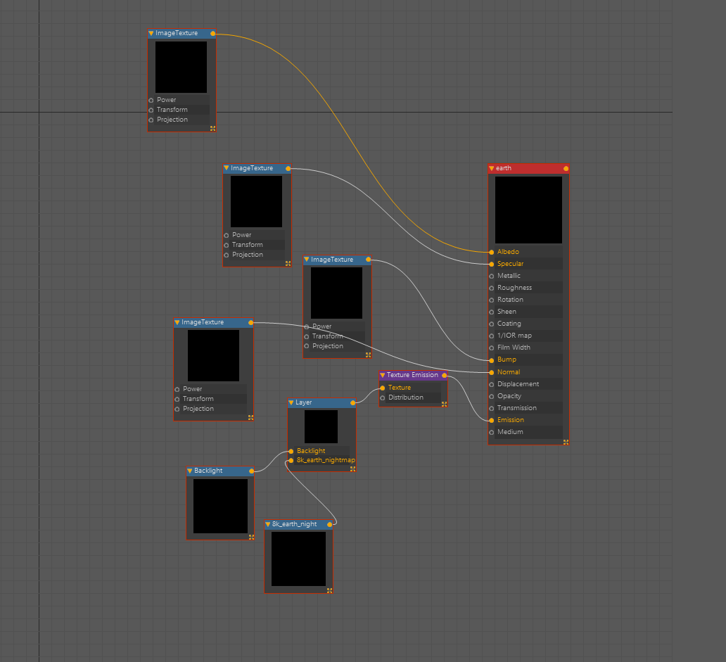

but when I render it in picture viewer (capture2) it doesn't render a portion of the material (capture3) it doesn't render the emission tab because of the backlight effect is c4d shader and this type of shader doesn't render?

Posts: 10651
you have posted in the wrong section, please, next time, use the c4doctane section instead:
viewforum.php?f=30
If you cannot post in this section, please write to help at otoy.com, sharing your Otoy UserName, thanks.
About your issue, please, avoid to use c4d shaders, and use only Octane nodes, for better results and stability.
In particular, use only octane nodes especially with emission, and the c4d Layer shader is not supported, and cangive great instability issues.
