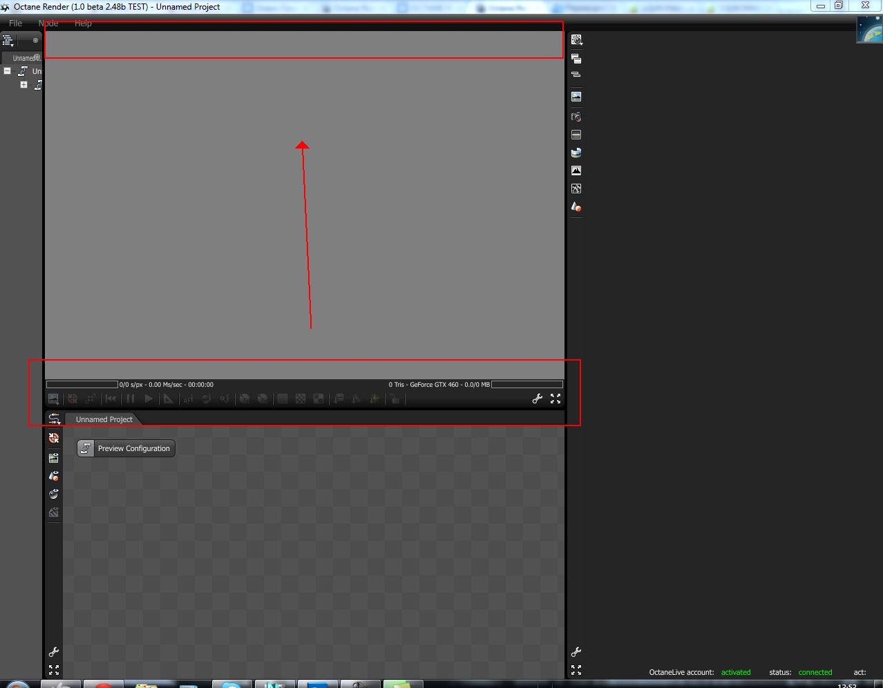

Hello!
Why when I tuned once the location of the panel, at the opening of a new octane it again at the original location!

The toolbar position and window layout is stored in your projects (i.e. each project can have a different layout). To make a specific layout the default, start a new project, set it up and click on File -> Save as Default. This will then be starting point (/template) of all new Octane projects.Elvissuperstar007 wrote:Hello!
sorry for bad english
Cheers,
Marcus
