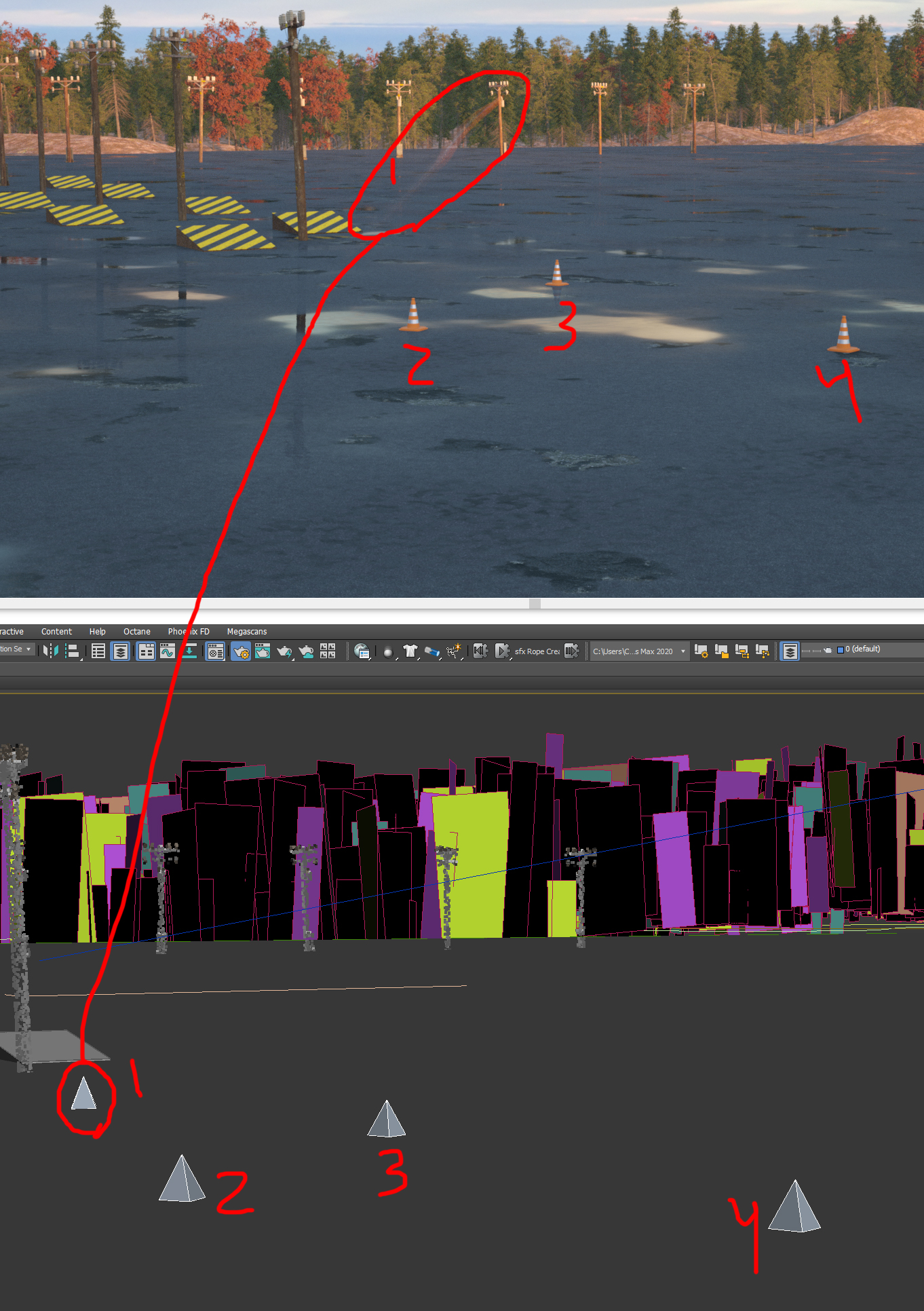

Why does this cone have movement and motion blur? it is a stationary object. They are scattered using itoo. This only happens when motion blur is on.
UPDATE: I attached the video. You can clearly see 4 cones scattered as path with itoo forest. Then I have electric poles scattered as path. If i choose electric poles itoo and make it a movable proxy 3 cones disappear (actually move so fast you can barely see motion blur). Not only why is it happening but how electric poles itoo influences cones?
I sent you the scene as PM Please try to set itoo geometry or actual itoo as movable proxy and mb on.
UPDATE:
I think the bug is related where octane doesn't treat itoo as movable proxy and itoo moving objects have problems with motion blur.
stationary itoo objects have motion blur?

Hi coilbook,
could you try setting "Direct" in Octane ForestPack support panel?
Regards
Paride
