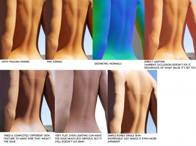

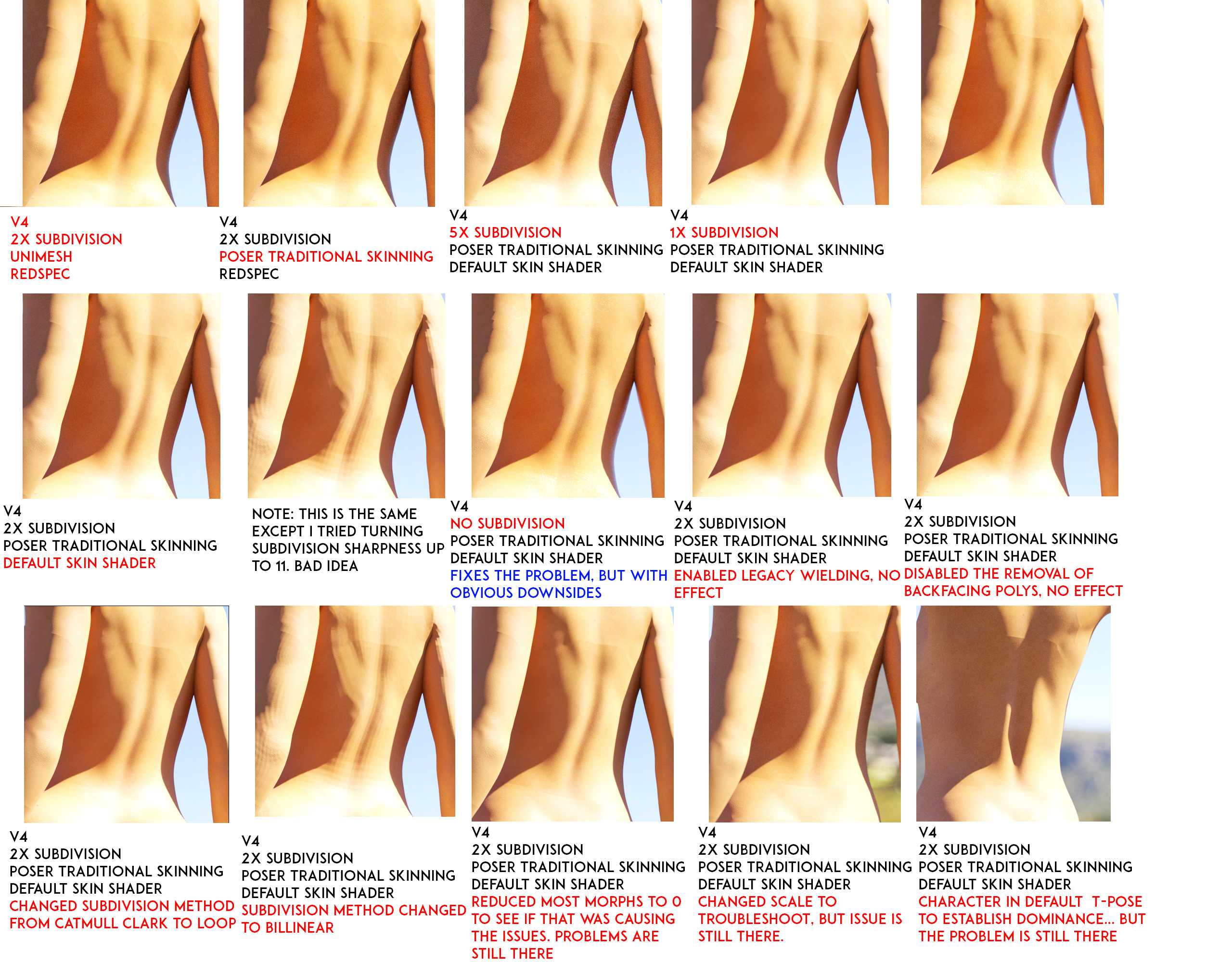

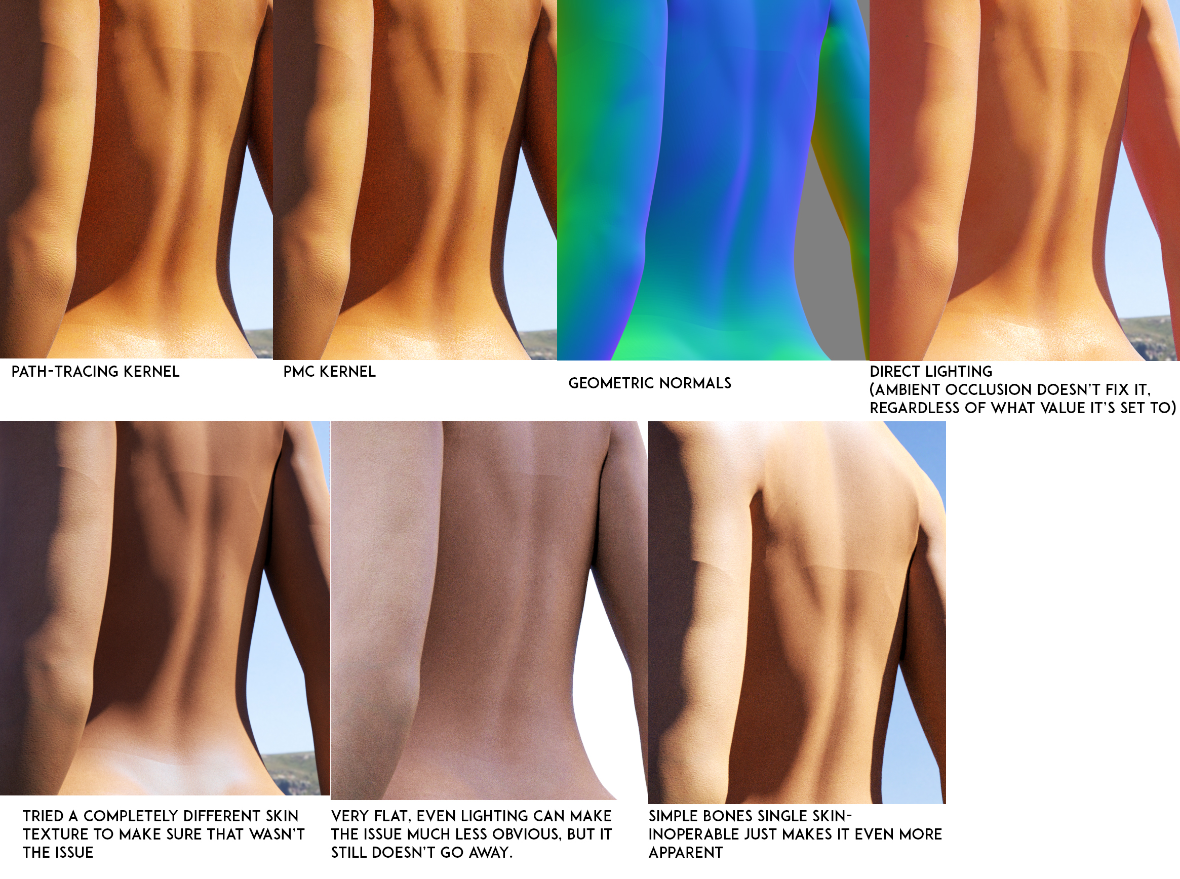

Changing the skinning method unfortunately doesn't fix the problem. I tried a BUNCH of different things, and the only thing that worked was turning off subdivision entirely, which of course has some obvious downsides. Check out the attached image to see all the different things I tried that didn't work.
It's not shaders. It's not morphs or scale. It's not the skinning method. It's... something. If there's some trick I forgot to enable, that would be great to know... otherwise, I suspect it's something that might require some kind of change to either Poser or the Octane plugin to fix, and I suspect I'm going to have more luck talking to you than to the Poser people, since (I'm assuming) a relatively small percentage of all Poser users have Octane.
It's not included in the image but I also tried playing around with Ray Epsilon and GI Clamp, among other Octane settings, and it didn't have any effect. Neither did changing the kernel.
I'm using Octane version 3.7.0.85 (later versions caused problems with some of my shaders so I'd prefer not to upgrade for the time being.) Poser version is 11.2.296.
I hope I'm not being too difficult, and if the issue is specific to version 3.7.0.85 , I'm guessing that fixing it isn't your highest priority... but I would appreciate any assistance you can give me. For the time being I can fix it in photoshop, but that's obviously not an ideal state of affairs for premium rendering software, and I really doubt I'm the only one who's affected. I'd really appreciate any help you can give me, thanks in advance!

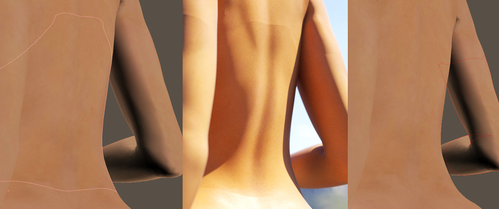

I did have unimesh enabled for a number of the renders (I labeled which ones in the images I posted.) And yes, enabling unimesh used to fix those issues for me... but now it doesn't. That's the whole problem in a nutshell, really.
The creases are definitely along the body part borders... Not the material borders, but the body part borders. You can see in the attached file where I compare a Poser real-time screencap with the abdomen highlighted, with an Octane area render of the same area. The images aren't perfectly aligned or scaled, but you can clearly see the shape of the abdomen reflected in the creases on the Octane render.
The attached Octane screenshot, by the way, is done with the model in Unimesh and the Octane smoothing angle set to 80.00, so clearly that doesn't fix the problem either. Also, for what it's worth, while I have mostly used a single scene to demonstrate the problems, it shows up with other characters, scenes and lighting conditions.
