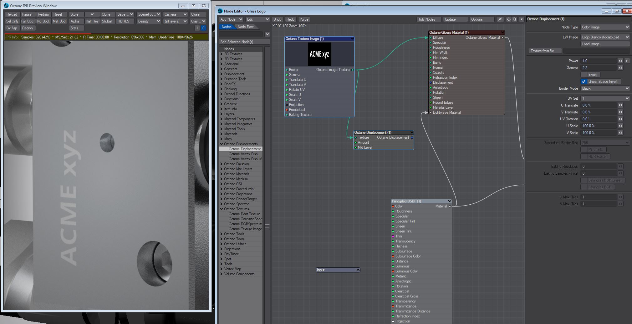

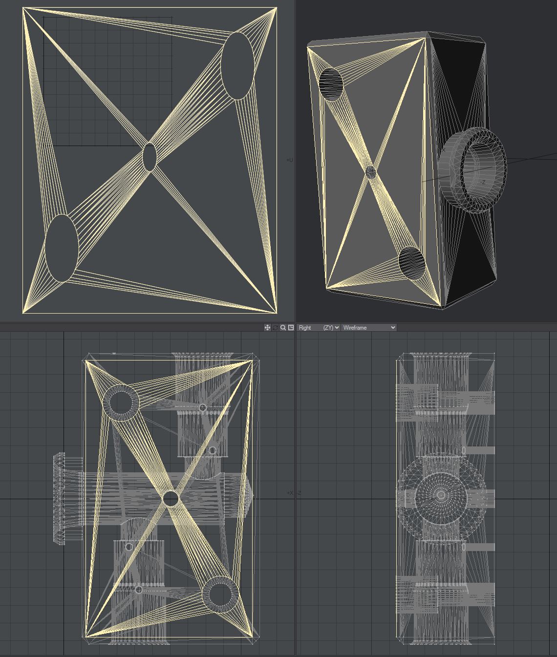

I need to put a texture in a precise place of more big surface. So I build the UV to place exactly the texture (Image 1).

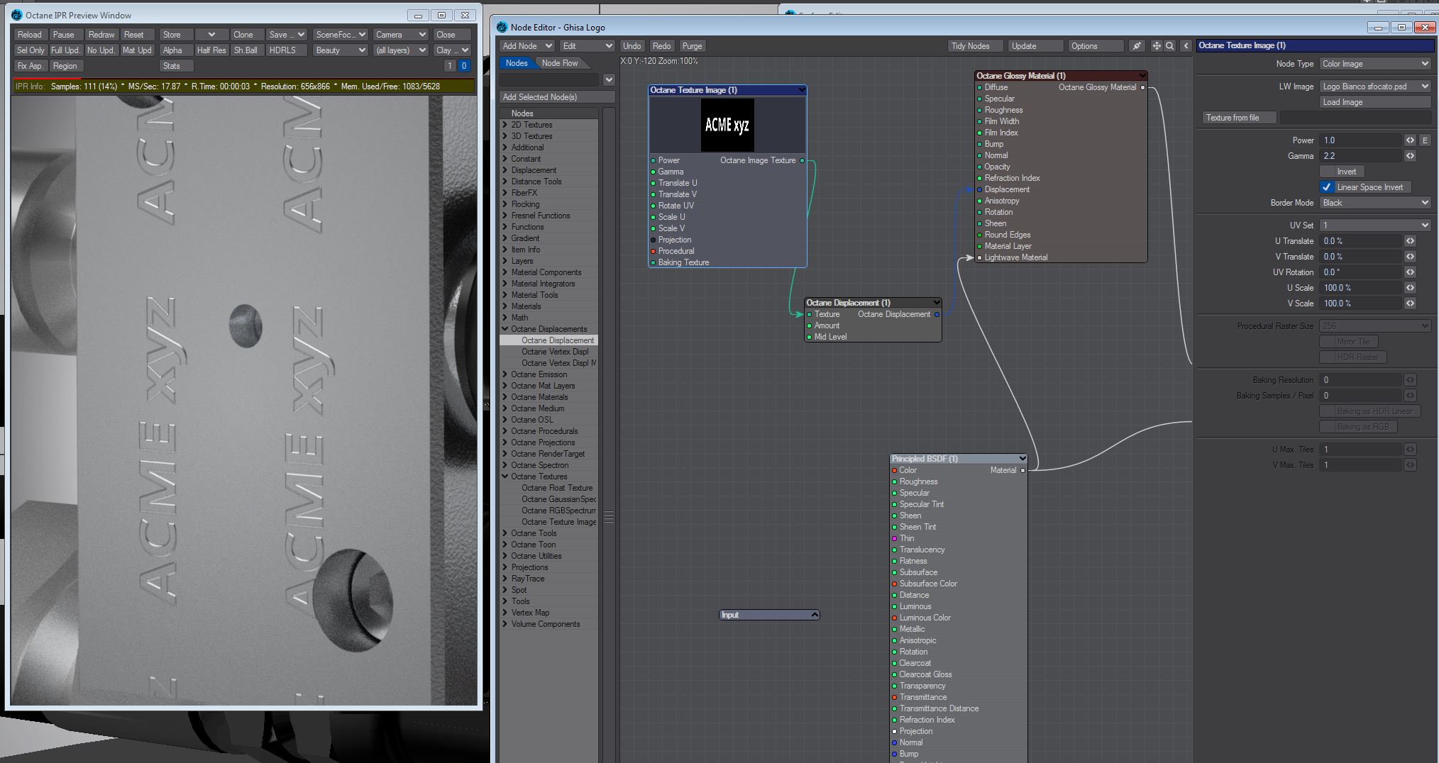

I use Black Border Mode, so the image isn't tailed on all the surface, and it is OK... if used in diffuse channel (Image 2).
But if I use the same texture in displace, it becomes tailed, as Warp Border Mode, not as Black (or white). Only Warp. (Image 3).

Displacement does not see any image parameters. You'll have to shrunk your UV map to fit completely within the UV grid.
