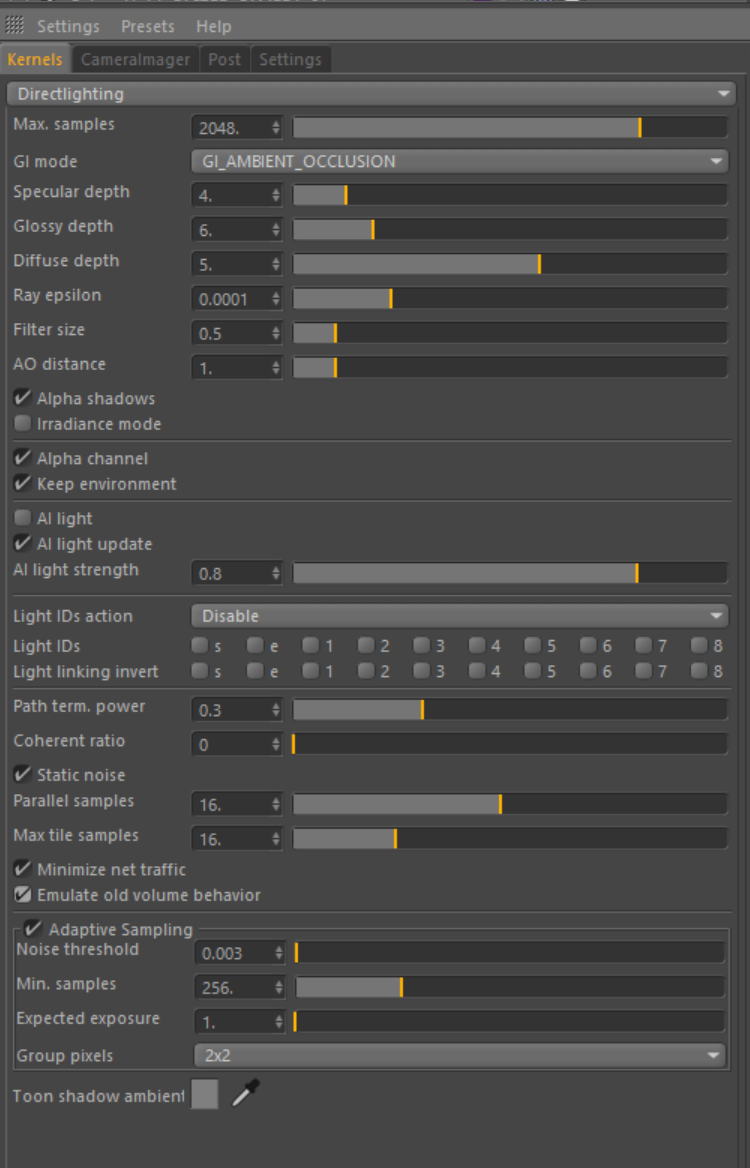

My HD render was fine. Now I am rendering the 4K final and my test renders are all extremely noisy. My PC doesn't seem to be running out of vRam or Ram by looking on the Task Manager.
The render starts calculating, I have adaptive sampling on set to 256 ( i have tried higher, lower). Once it reaches the 48 second mark I get a little notification at the bottom saying complete 0.003 (or roughly similar). Then the time keeps ticking until octane has successfully rendered and saved the render passes. The info passes look glorious. The light and beauty/ref/diff all look super noisy.
Denoiser is OFF. As my frames were crashing previously.
Any help/insight would be greatly appreciated. Thank You.
Current settings attached.
current settings.
current settings.

Are you rendering to picture viewer ?
On the the 'Octane Render' 'Main' tab, amke sure you have Time Limit (sec), set to '0', so that the render will continue until it reaches your max samples. Otherwise, it is cut short at the time limit.
That's all I can think of right now..
