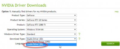

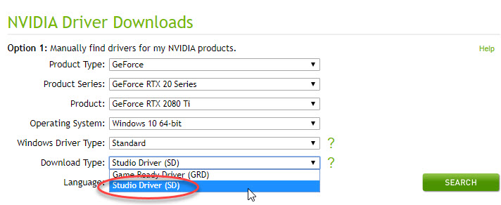

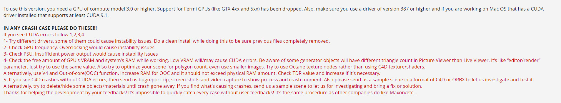

Why guys post here? Topic is from other guy with OSX, making confusing
Btw check images
Posts: 10618
under Win 10, please make sure to update to 1903, then perform a clean install of Studio driver 431.86:
https://www.nvidia.com/download/driverR ... 1050/en-us
Under Mac, please make sure to have CUDA 387.178 with Sierra, or 410.130 with High Sierra:
https://www.nvidia.com/en-us/drivers/cu ... r-archive/
All the other versions are not good for OctaneRender.
