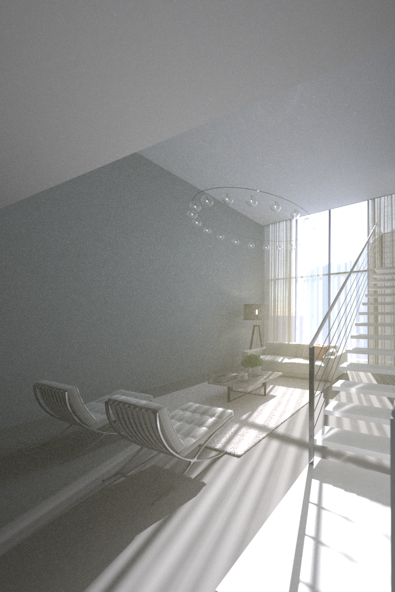

For a long time I find it difficult to generate an interior God Ray (volumetric light) in octane, we always complain the fog of environment medium is too difficult to use,
Yet occasionally today I found an interesting issue probably related, it is not the medium but the balance of the direct and indirect influence of the sun light is the key.
A testing rendering

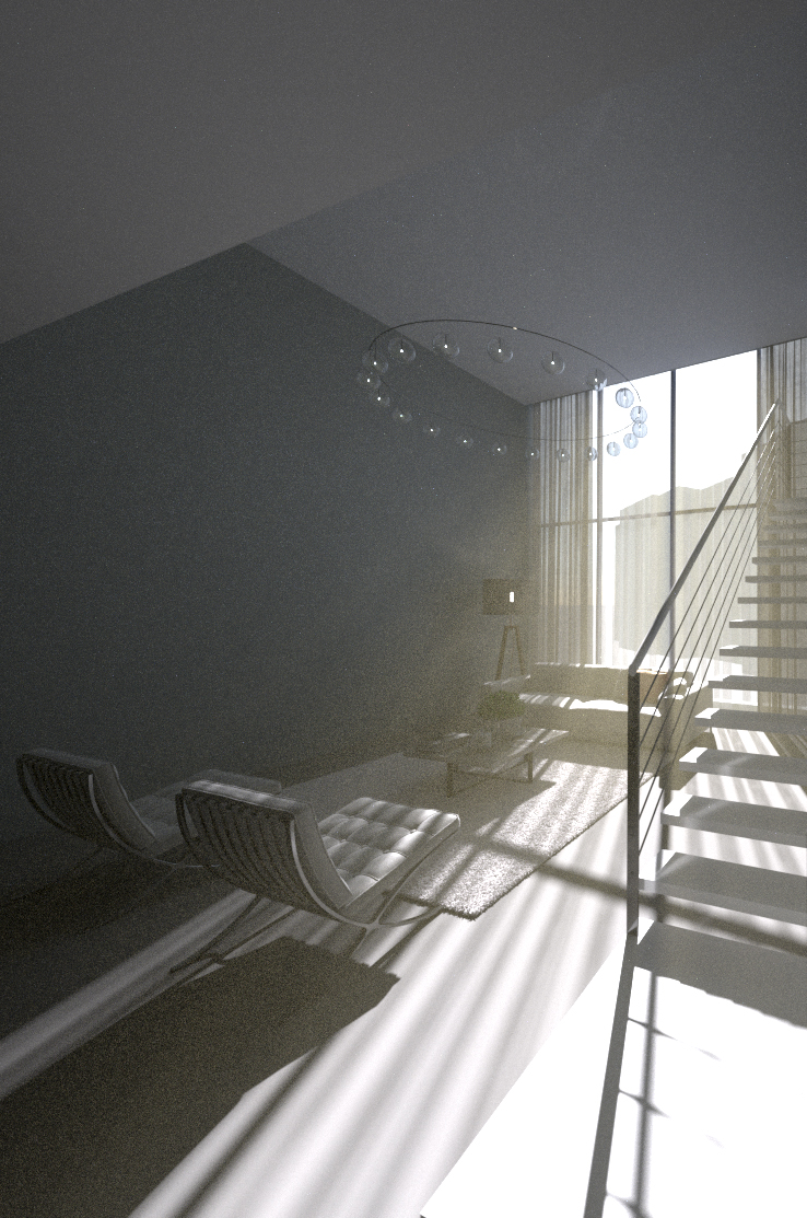

To generate this image I tweaked the parameters in the medium of Environment
the result is like this
quite disappointed,right? it seems nothing to do with the god ray

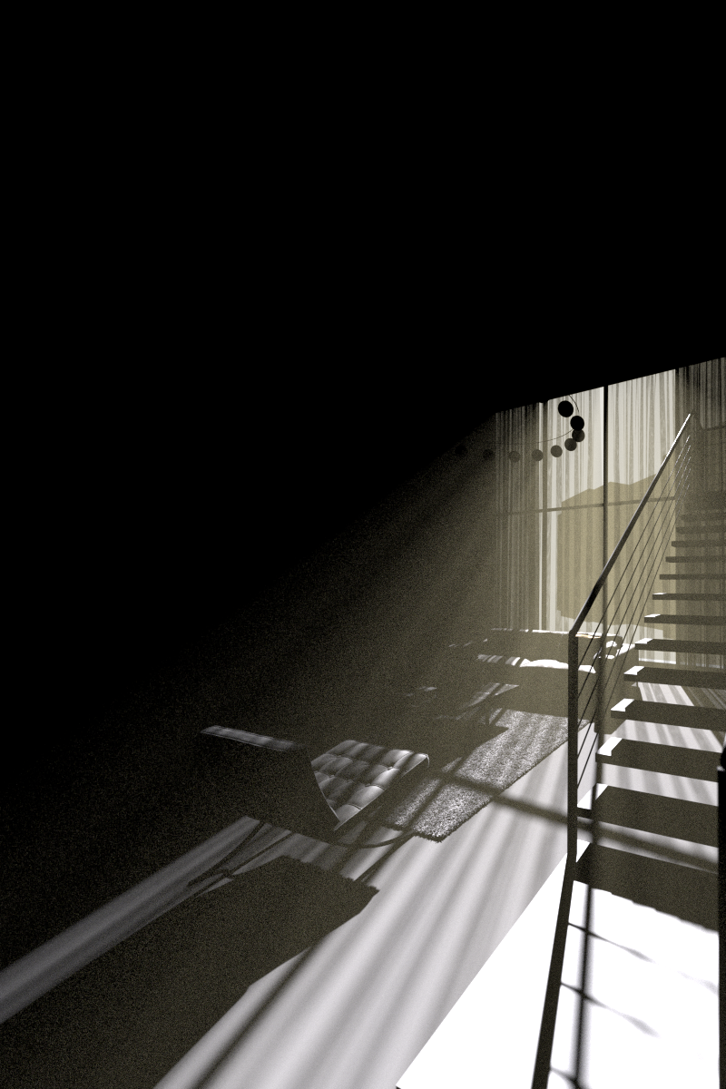

but interestingly the image in the sunlight direct pass shows a really strong effect
yet probably the image in the indirect pass is more dominant so that the final image do not show the God ray effect at all,

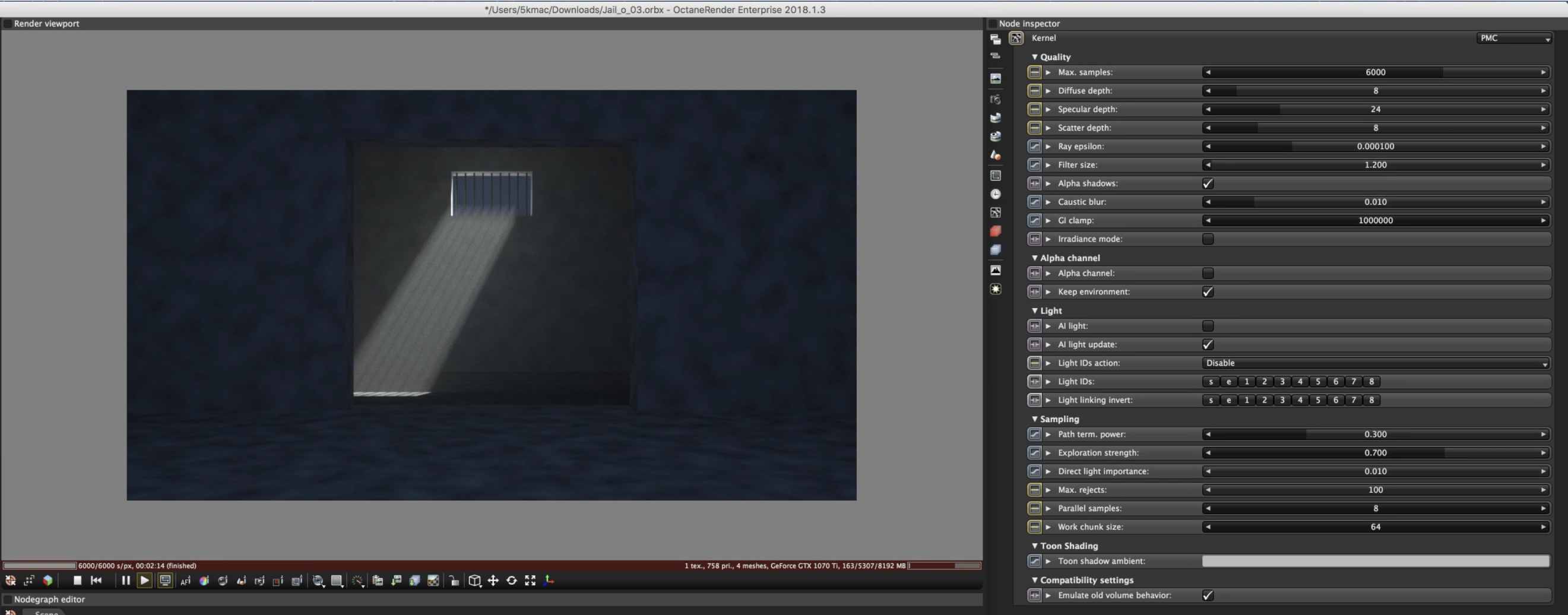

yes, the example was in Direct Light AO mode, so without GI.

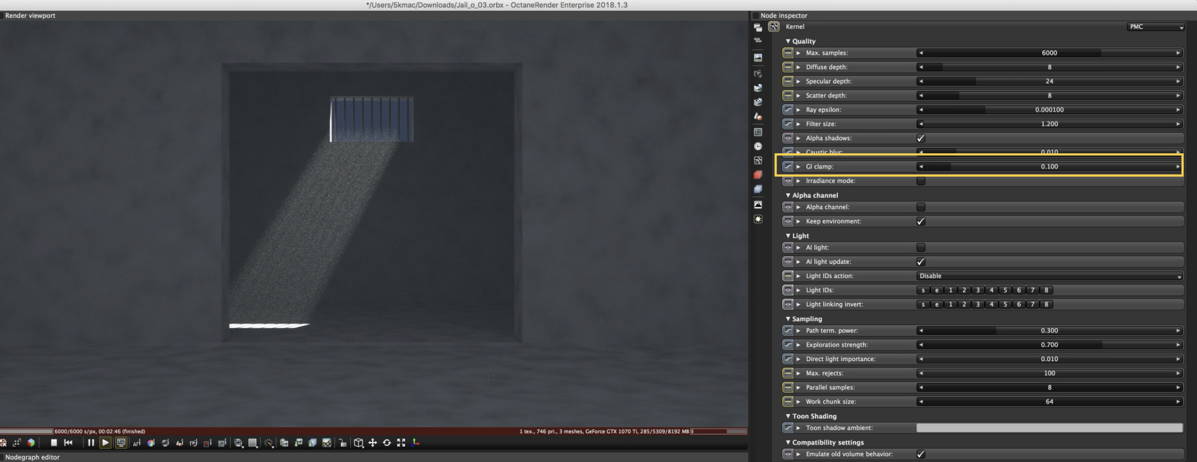

In PMC, if you use the old technique of the cube with specular/air material, with Camera outside of it, everything should work as expected, since the fog is limited inside the room:

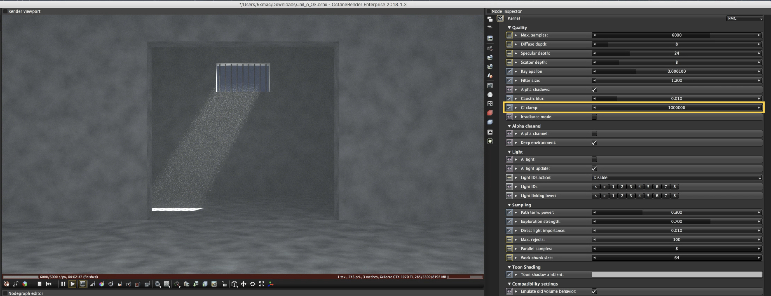

If you use the Environment node with Medium, all the scene is rounded by fog, so the GI/indirect illumination has a great impact:
You need to reduce the Sky light, or reduce the GI Clamp value, to have a similar effect with PMC:
Note that you, by reducing the GI Clamp value, you are also cutting the caustics.
ciao Beppe
